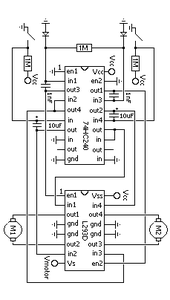

Introduction: Plant Host Drone
Easy and cheap to make P.H.D.
(Plant host drone)
With this you’ll never have to worry that your plant stands in the shades, always the best light for your favourite houseplant!
When you put the Robot in direct sunlight it will not run and he will just sit there and enjoy the sun, but when the day goes by and the sun moves he will follow the sunlight every time the shadow tries to take the upper hand.
When you start her up in the shade he will scout for light and therefore are the collision switches a helpful thing, so he wont get stuck somewhere.
-The parts needed to make this marvellous little robot are :
1x 74HC240
1x L293D
3x 1M resistors
2x 1nF capacitors
2x 10uF capacitors
2x SFH 300 photo transistor
2x collision switches
1x pot to host the plant (make sure it doesn’t leak water into the electronics)
and last but not least a recycled toy with 2 electric motors that runs at about 6volt or identical motors and wheels or a 2 motor robot platform. I think you can make this but for under 10$
-I gave my robot a nice flesh eating plant and designed the body a bit like a trilobite
And I used the Rp5 platform for this robot. I posted an image of my robot and the schematics
Enjoy!
