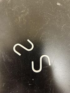

Clips (I used two different kinds as seen in the last two photos, but both work great)

For this step, I combined all the chains, hooks (after drilling holes first), clips, spreaders, and shelves. I used pliers to fasten the clips.
