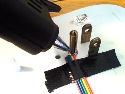

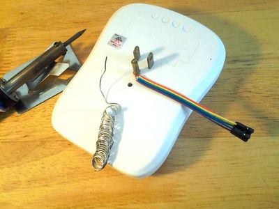

leave the positive (+) and negative (-) connections alone. we only need the 3rd prong, the only round one - ground.
you can twist your stripped wire together and wrap it around the ground prong. make sure to strip a good deal of wire cover. the longer the better.
also use your razor to scratch the bottom of the ground prong where we will be soldering, roughening this surface helps for a better solder job.
Step 2: Solder and Hot Glue
your connections. the tape is there to hold everything together in place to help.
i chose to leave the tape on there after done soldering, it doesn't affect the connections in any way but providessupport.
try to keep your soldering and hot glue job as low as possible to the bottom. this way most of your prongs will be plugged into the outlet. the outlet starts receiving electricity even half-way plugged in, so you still have a good deal of lead way here..
you could open the plastic cover on the outlet and hack the ground connection from inside and insert your female jumper cables to the body of the cover. but the outlet i'm using doesn't have any screws on it to access inside, i would have to break it or use a rotary cutting tool. if yours has screws, you should go this way for a much cleaner look.. make one !!

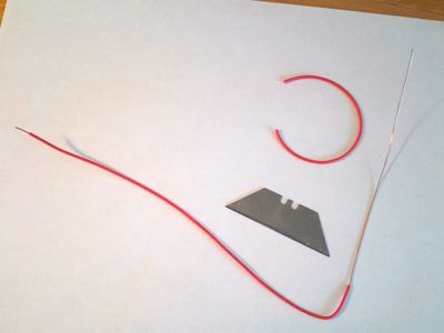

now strip your 22gauge wire as needed. first measure the distance needed.
strip one end about half an inch, this side will connect to the female jumper cables.
strip the other end as the same depth of your plant pot and stick into the soil.
you can also make a round, ring style grounding cable and insert it to an empty pot before adding soil for better results i assume.
