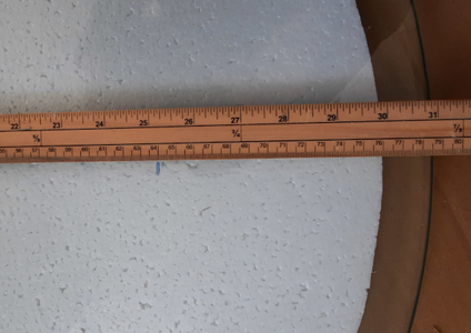

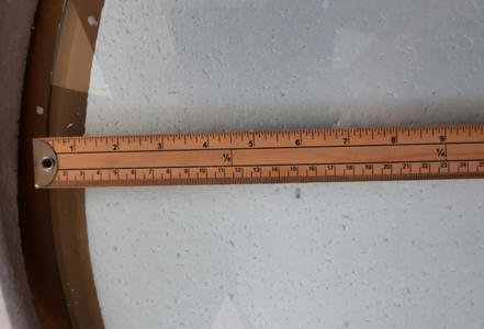

Step 4: Glass Plate Installation
To manipulate the plate, it is less dangerous to be helped.
  • Measure the diameter of the middle of the rim (diameter of the circle following the tips) - 49cm
  • On the glass plate with the erasable felt, trace 6 marks distributed on a center circle of 49cm of diameter
  • Put the tips next each mark and erase it
  • Put the plate on the rim of the pot and mark each tip position with pencil
  • Remove the plate
  • Stick 2 tips on both sides of each mark, let the place for a little more than one tip bewteen them
  • Reinstall the glass plate
