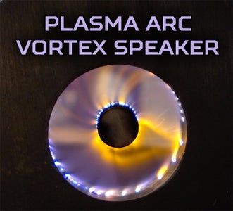

Introduction: Plasma Arc Vortex Speaker
About: Electromechanical Engineer, Product Designer, Maker. I love to make prototypes and teach others in the process. I graduated from UCF and spent two years working at NASA.
In this instructable, I will show you how to make your very own plasma arc vortex speaker! I set out to make the loudest plasma arc speaker with the fewest components. You can choose to make the vortex speaker or just a regular plasma arc speaker using this instructable. The regular plasma arc speaker is much louder, but the vortex looks so awesome so it's up to you!
After a few improvements, it already sounds much better here:
Warning! This is not a beginner project and has the potential to kill you if you are not careful. Please do not attempt this instructable unless you are aware of all the risks involved and have experience with high power, high voltage applications. The speaker can also generate dangerous levels of ozone if left on for too long in confined spaces. Use in a large room and don't use it for long periods of time.

The problem with the vortex speakers is that because the arc is rotating, it causes a fluttering sound that can't be silenced. Using this setup as a regular plasma arc speaker is really loud and clear. Enjoy!
