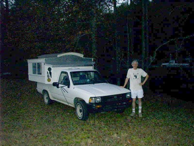

Back in 2004 a friend and I decided to go to the major Toy Train Meet in York PA. No hotel rooms available so I said lets camp! Jim was over 60 then and didn't think a tent would do. So I said how about a camper? I had loads of scrap wood and a pickup truck so I said lets see what we can build.
Step 1: Humble Beginnings
So I'm sorry I don't have more photos of the construction, but we were busy since we went from bare truck to camper in three days. We left the fourth day and the paint was still damp. Here are the important steps that we followed:
1) We used 1/2" "J" bolts to hold everything to the edge of the truck bed.
2) Everything else was held together with 1/4" bolts and "T" nuts for wood. ( See the second photo )
3) I did have the central roof left over from another trailer so that did help the project along.
4) All the parts were built one at a time and assembled in place. This way we were sure they fit.
5) Using the bolts and "T:" nuts allowed all the parts to be disassembled after each trip. Any where two panels are joined we drilled a 5/16" hole through both. This was the mounting size for the "T" nut and a nice clearance hole for the bolt. Pan Head bolts are good, Truss Head bolts are nicer.
6) In this picture you can see the base: Plywood and Hollow Core Doors bolted with the "J" bolts to the truck bed. There also is a filler at the tailgate.
Step 2: First Trip 2004!
So this is how she looked on the first trip. All white paint inside and out. The four Plexiglas side windows slide in grooves and are held shut with shoe laces. Jim's Wife made us railroad theme curtains that gave us some privacy. They were hung with simple cords tied to the various screws. We cut a scrap of carpet to cover the floor. Under the bed there was space for suitcases, food and even an ice chest. I was lucky to have some mattresses that fit and sleeping bags. For light we had two desk lamps plugged in to an outlet that we could power at campgrounds. All the roof sections were plywood with frames of 1x4 pine, or plywood. The center section had 1/2" plywood, but that was over kill and the other sections had 1/4" plywood. The front wall was 1/4" , the sides 3/8" and the back 1/2". Mostly because that is what I had on hand. We did buy the paint, tail lights and mirrors, but that was about it. We had a great time, and the roof didn't leak much on my side. We tried to divert the flow on Jim's side away from his head when he was sleeping. I found a coat of "Cool Seal" roof coating would seal most leaks so I would coat the joints each time the roof was assembled.
