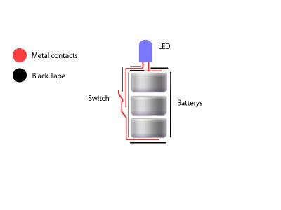

Ok. 1st u will need to get the guts assembled..
Get the battery's and tape them together leaving the 2 ends exposed (1 positive and 1 negative)
Be sure the sides are sealed.
Then attach the LED as shown, and then the paper clip bit for the switch.
Tape the led down well and the paper clip too so they are tight on the battery's.
Be sure that the contacts for the switch are held in place and secure.
Test to make sure all is well and that the LED lights up ok.

    Very easy to do. You would most likely want to add in a resistor though, but 3 1.5v batteries is probably okay, but I would add one in anyways. :P Nice job, I just got a TON of blue LEDs that I salvaged from this thing.. might try this out, looks great (yours) in the end. Nice job once again!
