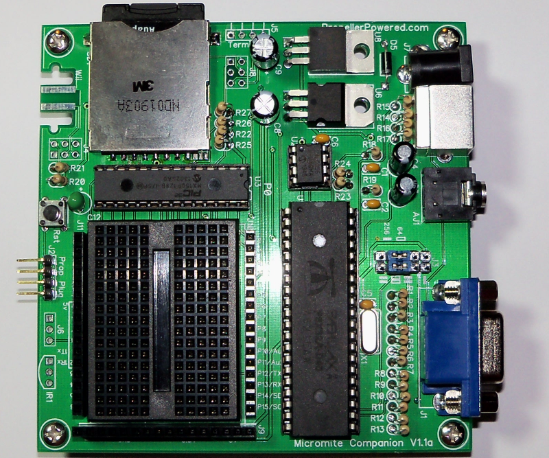

We've just released version 4 of the PMC project with a board called the Micromite Companion. By adding a Micromite to the PEB or obtaining our dedicated Micromite Companion Kit, you can do more with your projects than ever before. Completely compatible with our original PMC/PEB projects, the MMC now offers a very robust MMBASIC with 54K of free memory at boot-up.

Grab a ready-to-go Kit, or build your own from scratch!
If you have a favorite Propeller board already, and are comfortable with creating your own version of the Pocket Mini Computer, I've included both complete schematics and I/O configuration details on the last page of this Instructable. Complete source code is also available for download. (See step three) This is a fun project if you are building the Pocket Mini Computer or "Rolling your own" from the schematics, read on!

The brain (CPU) behind the Pocket Mini Computer is a Parallax P8X32A microcontroller, so grab your favorite Propeller board and dig in!
We'll be using the following I/O pins for connected devices:
  • P0 - P3     SD or microSD connection
  • P5             Optional iR Connection
  • P6 - P9     Optional SRAN 23K256 Socket
  • P10- P11  Stereo audio connections
  • P12-14      Optional AVout/Experimenter's Port
  • P24, P25   Wii Classic Controller connection
  • P26, P27  PS/2 Keyboard Connection
  • P16-P23   VGA connection
  • P4 & P15   Unused
  • P28-29      Quickstart EEPROM
  • P30-31      Programming/USB Communication
Schematics for all of the I/O circuitry used in the Pocket Mini Computer.
Higher resolution .PDF versions of both the core circuit and extended features can also be downloaded.
If you get stuck, don't hesitate to jump into the forums and ask questions!
