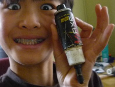

Introduction: Pocket-Sized "Air"osol Can
Have some small empty aerosol cans lying around your house, but don't want to throw them away?
Well, here's some good news! I'll show you how to convert it into a refillable "Air"-osol can (literally - it uses compressed AIR) so you can use it as a personal emergency misting device, flamethrower, or simply something to cool you off with.
If you like this instructable, please vote for me in the new Pocket-Sized contest! I could really use a leatherman :D
As a side note, if this instructable looks really long and complicated, it's not, really. I just made it really detailed and informative so that it's foolproof XD

Step 10: Pump It Up!
Unscrew the tire valve cap, and hook it up to your pump.
Pump it up until the gauge reads about 35-40 PSI. You probably shouldn't pressurize it more than 50 PSI.
Check for leaks. If there are any, it might work if you seal it up with more PL Premium (I don't know for sure if this will help) and let it dry.
Detach the air-osol can. (Yay, you can finally call it that!)
Spray to your heart's content (or until the air runs out)!!
