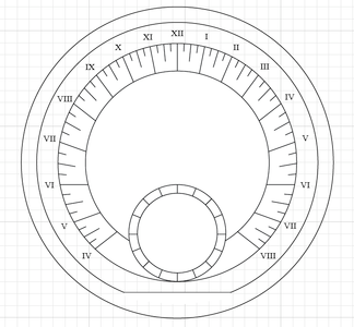

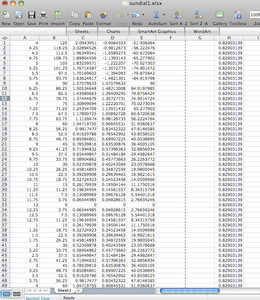

The main feature of the sundial face is, of course, the lines that will eventually be used to indicate the time. It is important that these lines are at correct angles to insure that your sundial will be accurate. The equation to determine the angle of each "time line" (Ø) is this:
           Ø = Tan-1(Tan(t)*Sin(L))
               Where:   t = the angle from 12 on a normal clock [ t(noon) = 0°, t(1:00) = 15°, t(2:00) = 30° , t(11:00) = 15° , etc.]
                             L = the geographical latitude where you are, or where you intend to use the sundial
This will need to be done for every line you intend to put on your sundial. But dont worry, Excel is here to save the day! Above, you can see a screen shot of my spreadsheet with the equations used in each column.

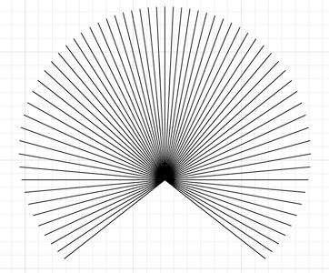

Your lines can be at every hour, every half hour, or every 15 min (any more than that is probably beyond the precision of the sundial, and not worth the extra time and math). Mine are every 15 minutes from 4am to 8pm.

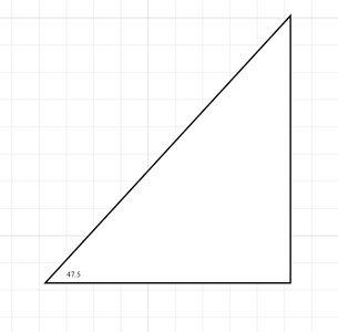

Your latitude will also be important in making the gnomon (the piece that stands vertically and casts the shadow on the sundial's face). The top edge of the gnomon will be the part of the shadow which will line up with the time lines. The angle between this edge and the face of the sundial must be equal to your latitude. Other than that, the gnomon can be as simple as a right triangle, or a complicated as you want.

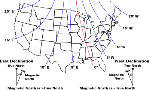

In addition to your latitude, an other value you will need to know is the magnetic declination of your location. A compass points towards "magnetic north", but for an accurate sundial, you will need to know which direction "true north" is. Again, this will depend on where you are on the earth, and can be determined using the map above, if you are in the continental US. Sorry, to everyone else. However, I am sure that similar maps can be found for other regions of the globe.

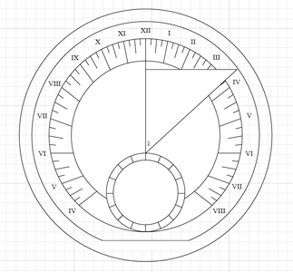

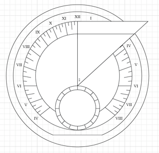

Step 3: Design Your Dial
Step 4: Test Your Design
Once you are satisfied with your design test it out to make sure it works as expected. To test it, print out the face design and glue it to a note card. Then cut out a right triangle gnomon, glue it to a piece of note card and tape it to the face. Find a safe place that will receive direct sunlight for a significant portion of the day (like a windowsill). Position the sundial so that the gnomon points toward true north. Observe the dial for at least one full day, checking how accurate the sundial is (compared to a clock that you know is correct). Keep in mind that the sundial will not change with daylight savings, so it will appear to be one hour behind while daylight savings time is in affect (be sure to remember this when actually using it as well).

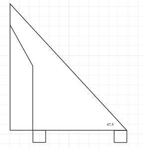

My method for making and attaching the gnomon is to design it to have two small pegs that will line up with slots in the dial face to keep it in place and properly aligned. With this method it is also possible, and easy, so make several gnomon that can be used interchangeably for either a different look or incase one breaks
The gnomon can be made from just about any sturdy material, however many metals will screw up the compass reading and should not be used in any part of the sundial. I used a stiff piece of plastic (polypropylene actually) that I cut from the lid to a large plastic jar. Whatever material you use, make sure that it will not break or bend too easily, and be sure that it is flat. Print the design and tape it to the piece of material (I like to use double sided tape), and the cut the shape out of the material. Be very sure that the "latitude corner" is at the right angle, and be sure you know which corner it is.
To make the slots, I used the tool that comes with the dremel for opening and closing the collet. The end of the tool with the flat head is just the right size and shape tor create the slots. Before making the slots, be sure to draw a vertical line along where the noon line will be, and mark where the two slots should go (from the point where all the time lines meet, up to where the time lines are visible in your design). It is a good idea to use a print out of you design as a guide. Then, use a hammer to pound this end of the tool into the face a bit. Check with your gnomon to see if it is deep enough. If its not, keep pounding it in a small amount at a time until the gnomon sits flush and the pegs cannot be seen. At this point, check again that the angle is correct (sanding can fix it if it is a little off). It is a good idea to test this method on a scrap piece of wood first.
