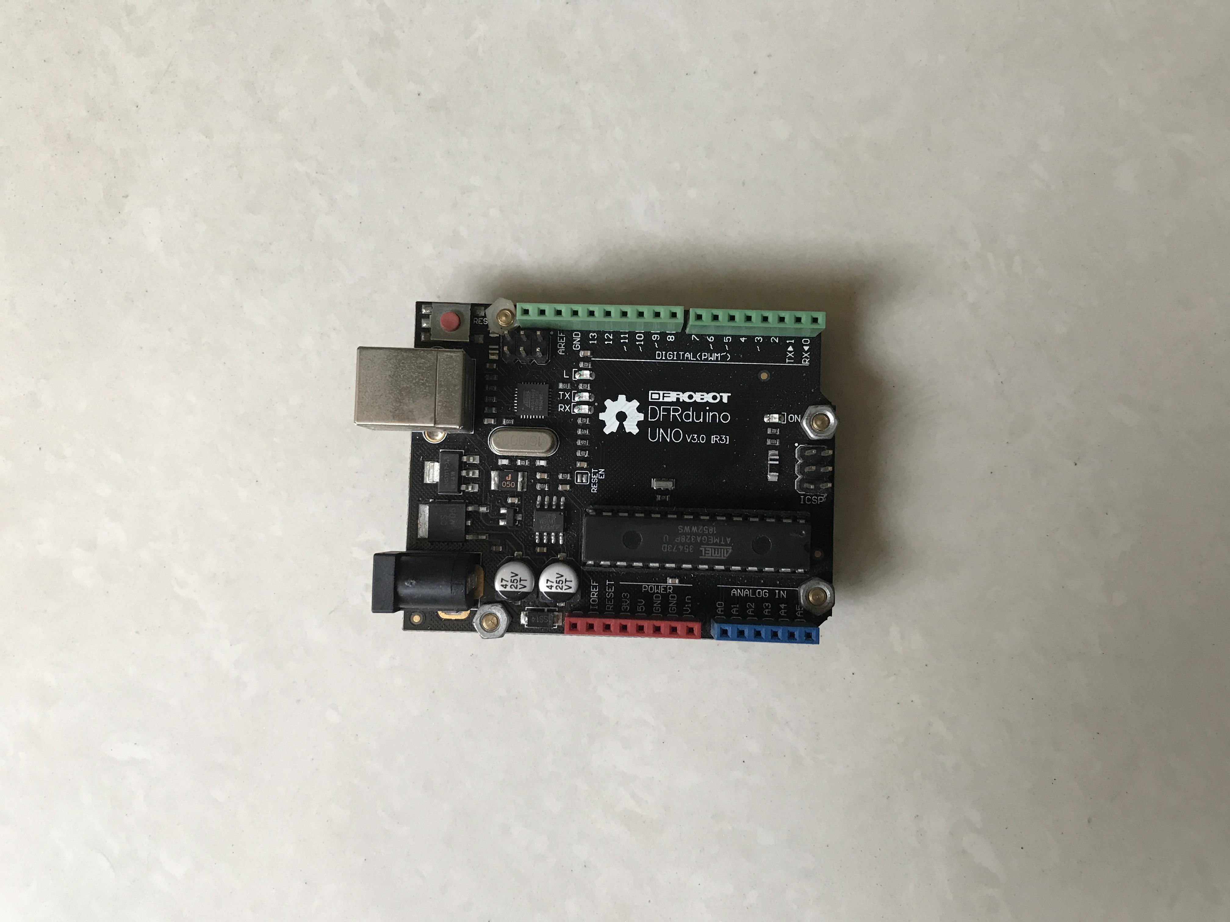

⦾ Controller options:
- 1pcs x DFRduino UNO R3 - Compatible with Arduino Uno + 1pcs x Arduino CNC Shield V3 GRBL.
- 1pcs x DFRduino Mega2560 + 1pcs x RAMPS 1.4 Controller.
- 3 Axis Control Board GRBL With Laser Engraver Supported.

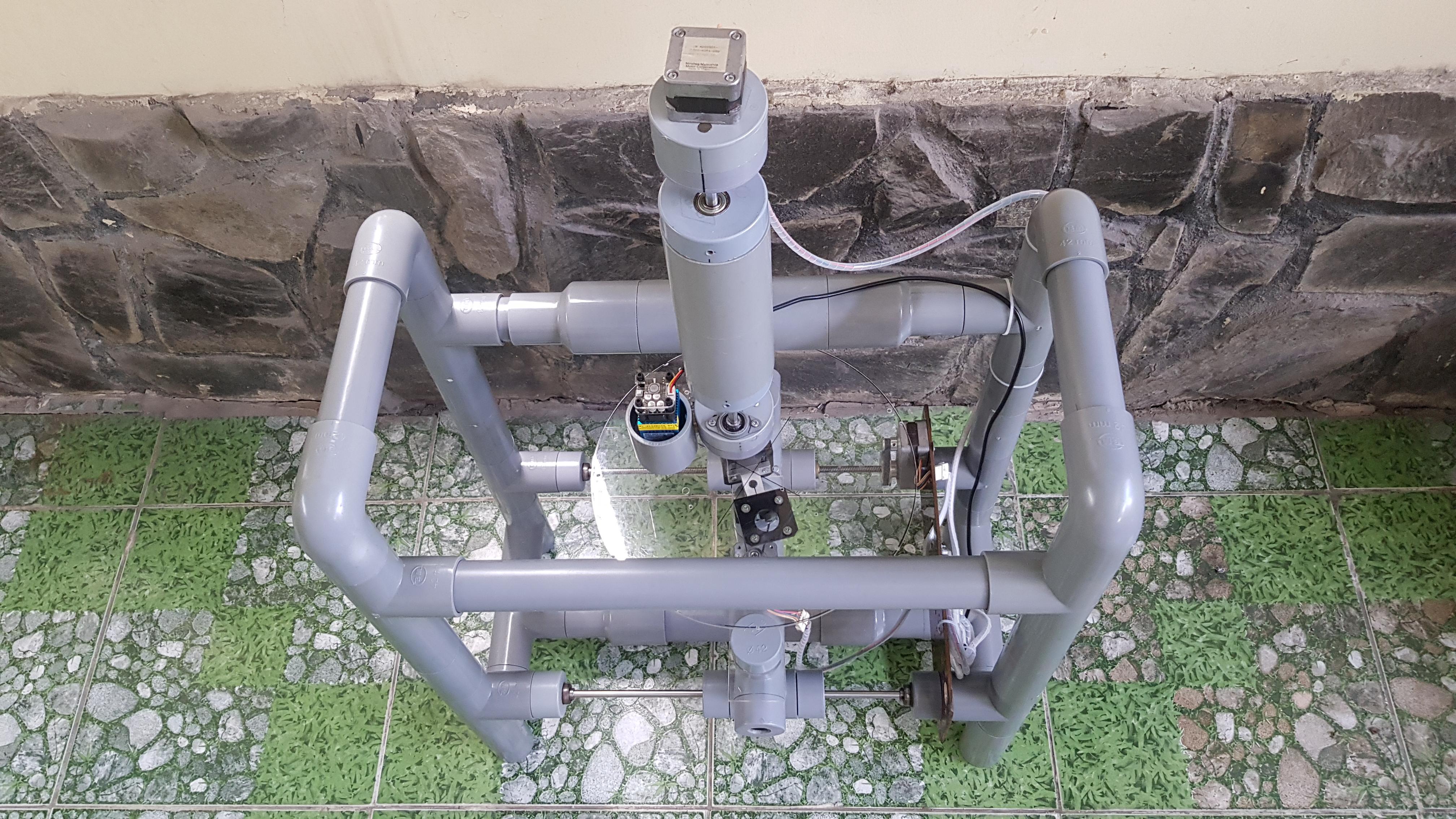

Step 1: Build Rotary Y Axis
Cut an A3 sized acrylic sheet into a circle form with a diameter 297 ~ 300mm. Two motor L-shaped supports and two 8mm linear rail shaft clamping guide supports were mounted on acrylic sheet so that the shaft supports center hole and acrylic sheet center were aligned together.

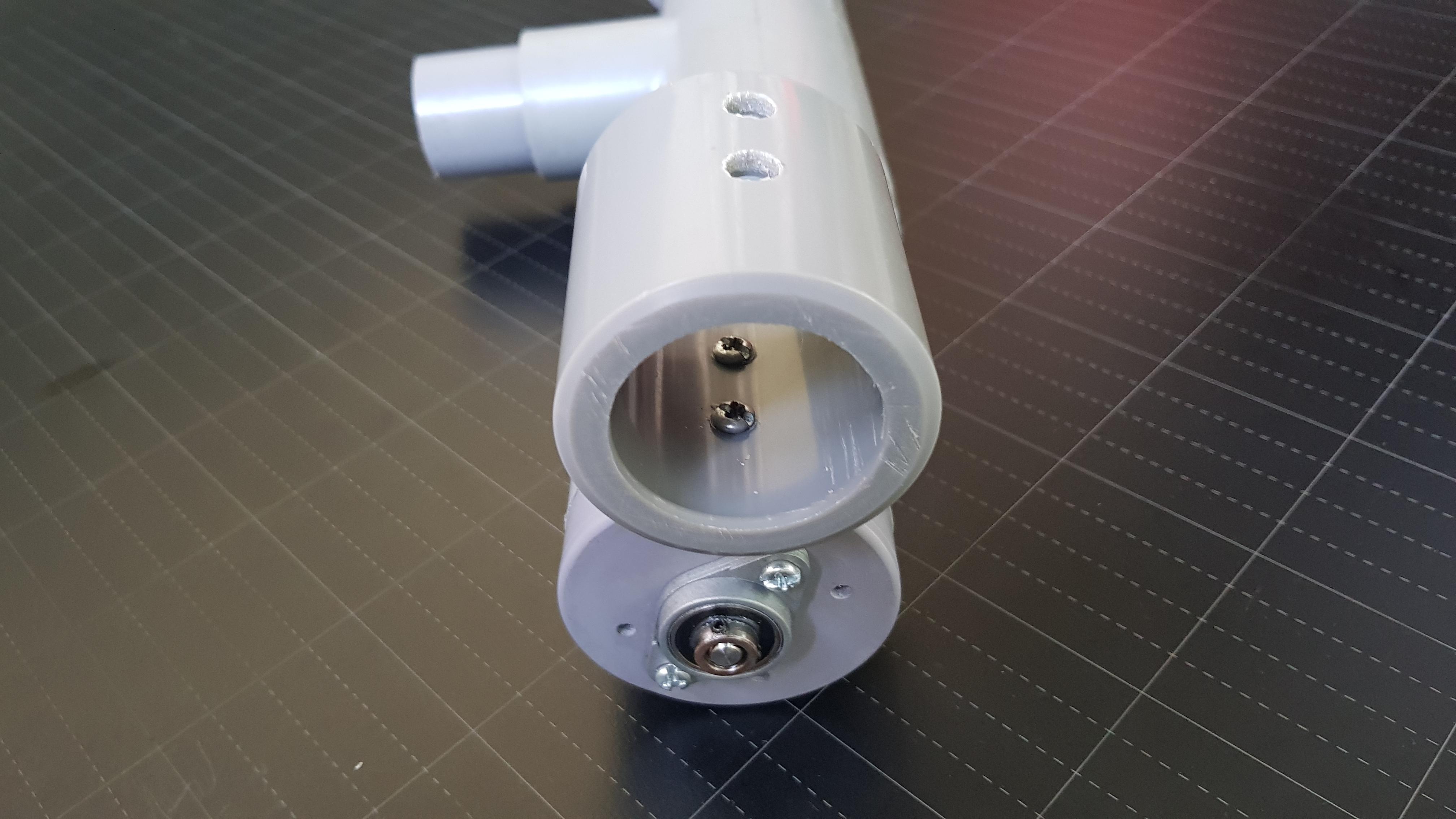

Assemble the rotary motor support, it included:
- 3pcs x PVC pipe cross Ø42mm.
- 1pcs x acrylic sheet for mounting rotary stepper motor.
- 3pcs x PVC end caps Ø42mm.
- 2pcs x bearings at top and bottom of middle cross.

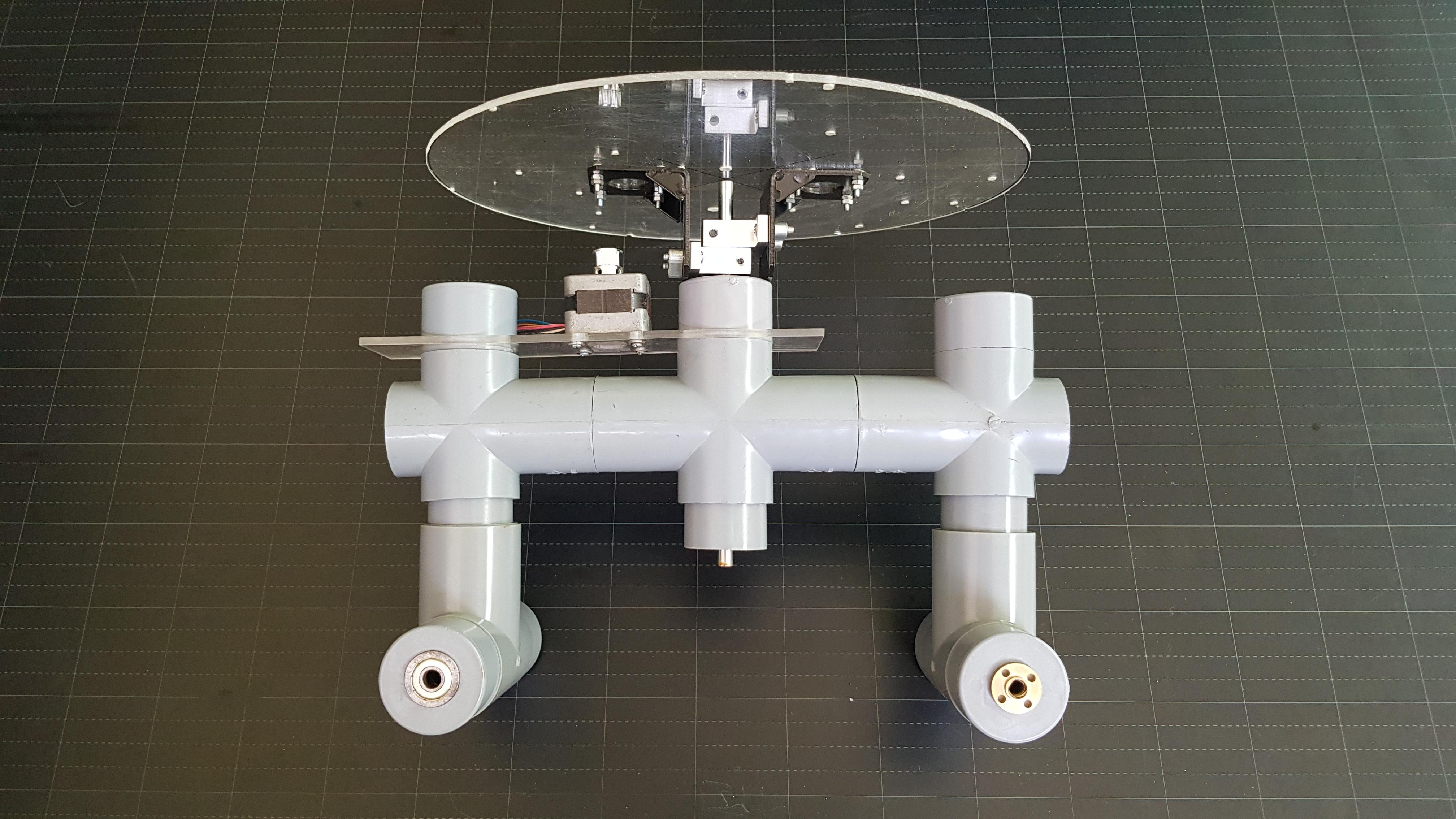

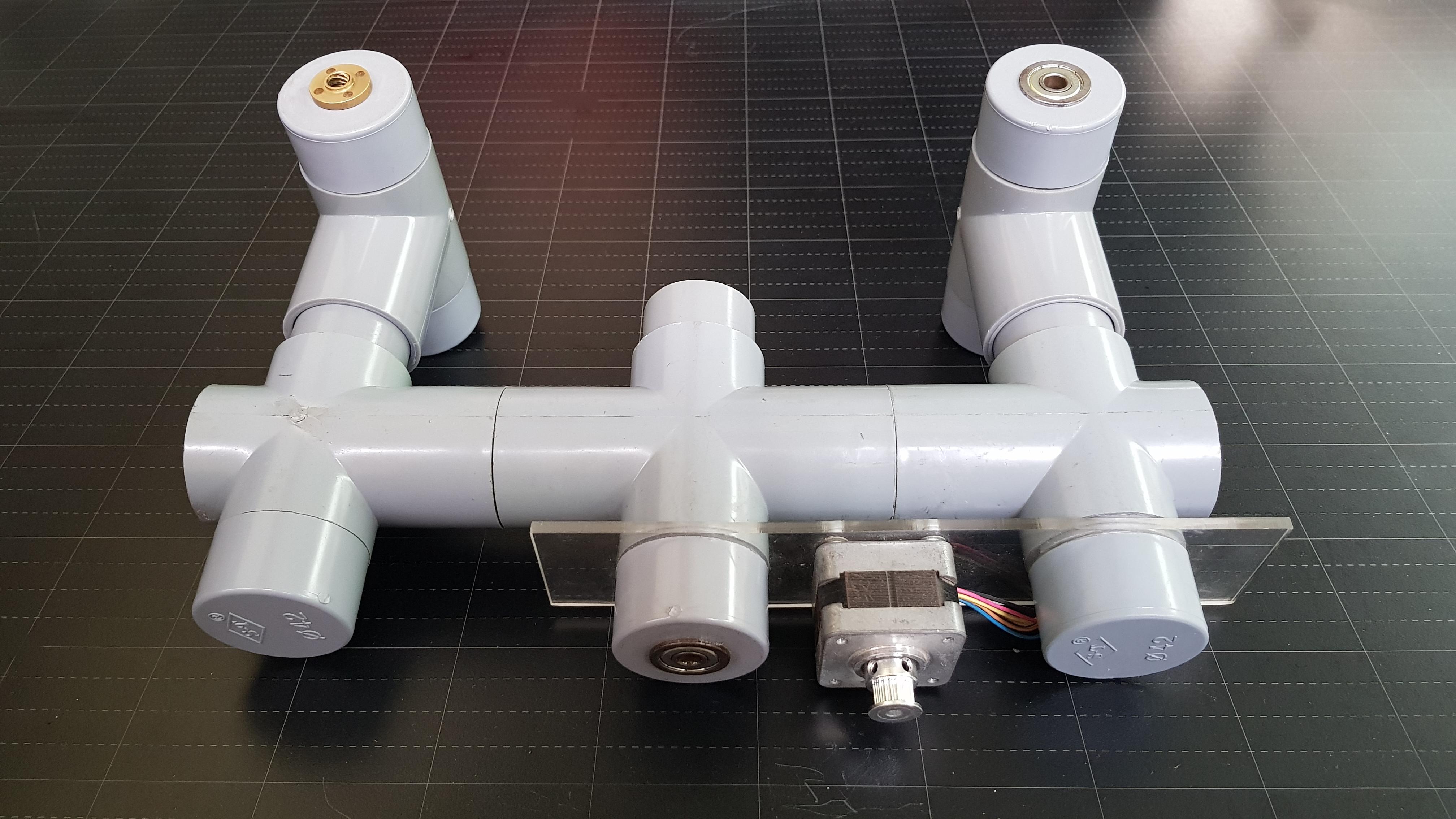

Step 2: Build Linear X Axis
From rotary support, I continued to build up the linear X axis by:
- Mount two PVC pipe tees Ø42mm to left and right crosses of rotary base.
- As picture below, left tee will thread a lead scew and right tee for a round shaft. So they were installed copper nut and bearings on their end caps, following their functionalities.
Install rotary working plate on this base.
Thread a lead screw and T8 round shaft through copper nut and bearings.
Step 3: Build CNC Frame
Assemble main CNC frame, included: PVC tees Ø42 & Ø60mm, straight connector, elbows, reducer Ø60mm to Ø42mm, pipe Ø42 & Ø60mm.
On the main frame, one wooden support was installed. The X stepper motor and CNC controller will be mounted on it.
Step 4: Build Linear Z Axis
Mount Z stepper motor on the base which was built of 2pcs PVC end caps Ø60mm, connect the motor shaft to a lead screw by flexible coupling 5x8mm. The Z working base was also built of 2pcs PVC end caps Ø60mm and connected to the motor base by lead screw and shaft 400mm.
Build a tee reducer (Ø60mm to Ø42mm) support which included copper nuts and bearings. This support was used to mount the Z-axis to the main frame.
Install laser holder at Z axis working base.
Install laser module on the pipe support & Z axis was done!
Step 5: Assembly
Mount XY axes to main frame, connect stepper motors to lead screw and rotary platform by closed timing belts 200mm plus 60 teeth pulleys.
Adjust a top middle pipe support to mount the Z axis so that the laser head center should come across the rotary table center when moving the X axis back and forth.
Mount Z axis to main frame.
Done!
Step 6: Connection & Controller Options
I have connected & tested my polar CNC on the following hardware options:
⦾ DFRduino UNO R3 + Arduino CNC Shield V3 GRBL.
⦾ DFRduino Mega2560 + RAMPS 1.4 Controller.
⦾ 3 Axis Control Board GRBL With Laser Engraver Supported.
With the hardware selection: DFRduino Mega2560 + RAMPS 1.4, we can apply built-in polar kinematic that can convert directly to polar coordinates without extension software. And there are some good references with RAMPS 1.4 that has been applied to 3D printers, such as:

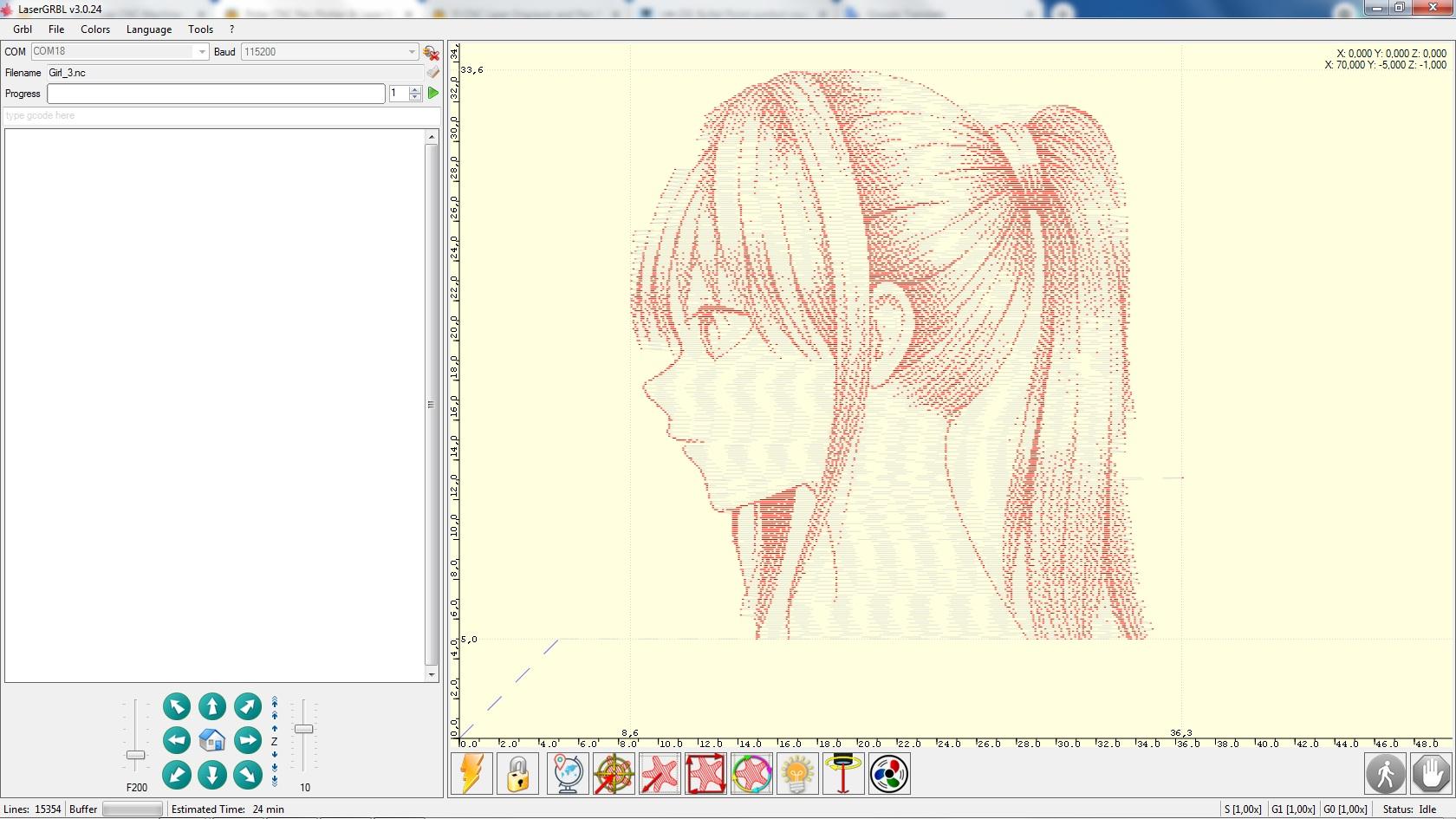

Step 8: LaserGRBL
⦾ Download & install LaserGRBL in your computer.
⦾ Open a picture with LaserGRBL.
⦾ Select “1bit BW dithering” tool from conversion tool options.
⦾ In Laser Options, select:
- Laser ON: M4.
- Laser OFF: M5.
- Type S-MIN (0) and SMAX (150) based on Laser Module power and plywood.
⦾ Click File ➡ Save Program. This picture's G-code is generated and saved with Cartesian coordinates.

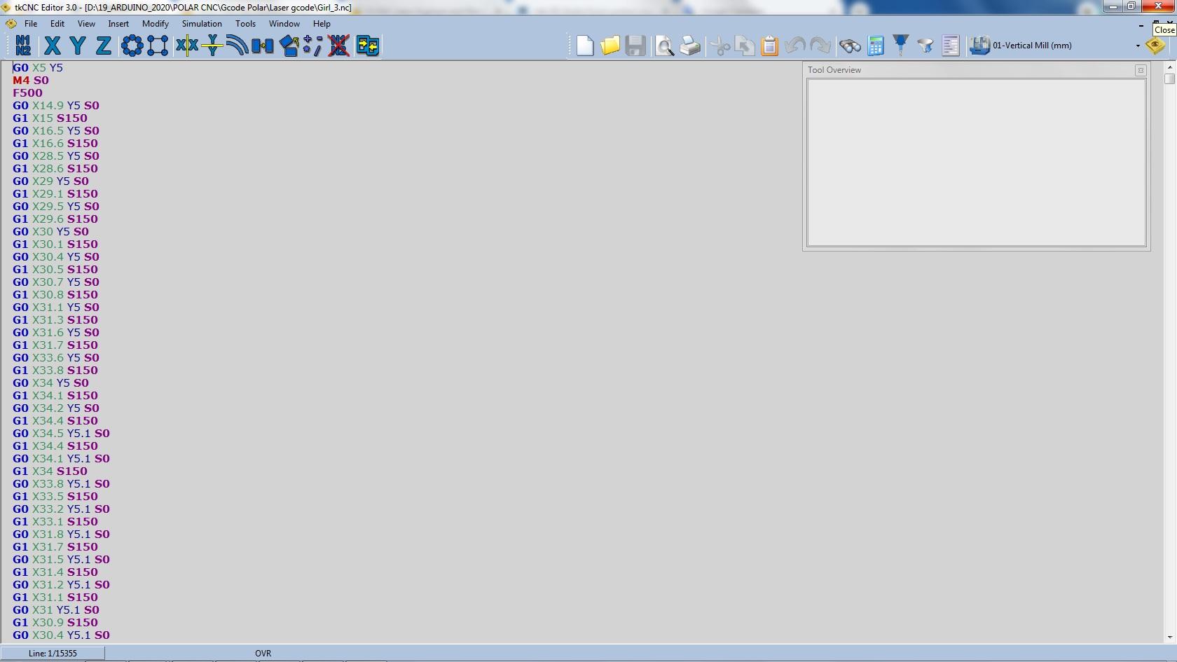

Step 9: Cartesian to Polar Conversion Tips
Open file GCODE file by tkCNC Editor software.
As we can see in the GCODE file above, S0 is a command to turn off the laser module and command S150 is to turn on the laser with a power 150 compared to the maximum power 255.
We need to replace S0 and S150 with M5 and M4 before performing the conversion to polar coordinates. Otherwise tkCNC Editor software will not understand G0 or G150 commands and they will disappear after conversion.
Go to "Modify" ‣ Select "Cartesian to Polar Conversion..." ‣ Set-up polar parameters in window pops up ‣ Click "OK".
Note that polar coordinates are represented by X and C in this software. So we need to replace "C" by "Y" and "M5 & M4" by "S0 & S150" ‣ Click "Save CNC file as" with difference name. Finally, we open this modified GCODE in LaserGRBL, it looks like this:
