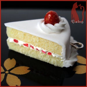

Making realistic polymer clay  cakes is ridiculously fun and easy. Once you learn a few basic tricks you can do pretty much anything you've always wanted to eat (but please, don't eat them!). They make great gifts and dollhouse decorations, and they're sure to surprise your friends.
I'm going to teach you the basics to polymer clay cake making, and a few ideas to decorate them. I'm uploading some of my best cakes for inspiration, but going to your favorite cake store is also highly recommended. This is a very addictive activity, I hope you'll enjoy it and if you need tips please let me know! I'm always glad to help.
This instructable will cover:
  • How to get a realistic translucent cake. Not opaque or chalky.
  • How to make a realistic cake texture.
  • How to decorate your cake with fondant, icing, etc.
  • How to pipe polymer clay.
I'm also including the cutting template and scale conversion table that I made because I hate uneven slices of cake. Please feel free to download it, print it and use it as much as you want, it works for many other projects too. Just please don't redistribute it.

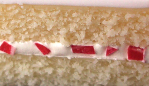

Step 5: Texturing the Cake
This step is where most people have problems and which will determine how realistic your cakes look.
First take a toothpick and scratch the surface in any random motion. We're making a rough pre-texture, so it doesn't need to be perfect. Next, use a needle and gently scratch the surface in small circles, this will achieve the cake texture. Don't stab it! Holes don't look natural. Get rid of hard scratches and anything that looks weird.
TIPS:
  • Texturing is very time consuming. Some crafters only use a needle, but it's so thin that it takes a long time to texture all the surface. I found that if you use the toothpick first, it cuts the texturing time in half (sometimes less!).
  • I've found that there's really no way to over do it, actually, it looks better the more you texture it. But don't texture too deep! You want to texture only the very surface, be gentle. If you're getting chunks out of your clay, you're texturing too deep.
  • It really pays to learn how to very gently hold the slices. I no longer need to freeze the slices when I'm holding them, and I can ow hold anything without squishing it.
  • This technique is easily mastered after a few tries, so don't give up! Keep practicing.
  • Use pointy needles and toothpicks, anything blunt will not work as good.
