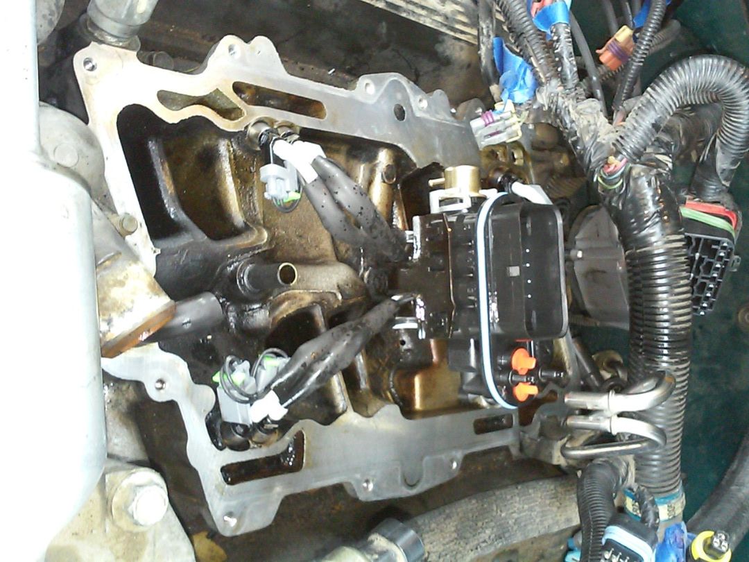

This guide explains how to clean/repair  leaky or stuck poppet valves/injectors. only continue if you are sure that your injectors are getting a signal from the ecu and are actuating. if your not sure, Google it, do your testing and come back.
I am not responsible for any kind of damage or injury you may cause yourself or your car.  Messing around with a fuel system is dangerous, gasoline leaks can and will cause fire and or explosion. Be Safe, Be Smart, Or be Dead.
Step 1: Take a Look at the Injector and Get You Stuff Together
At this point you have pulled the injectors from the fuel meter body, you have your injector reseal kit with all of the o-rings napa and everyone else has them .

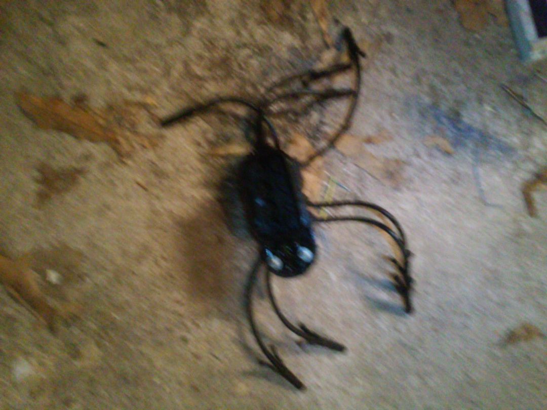

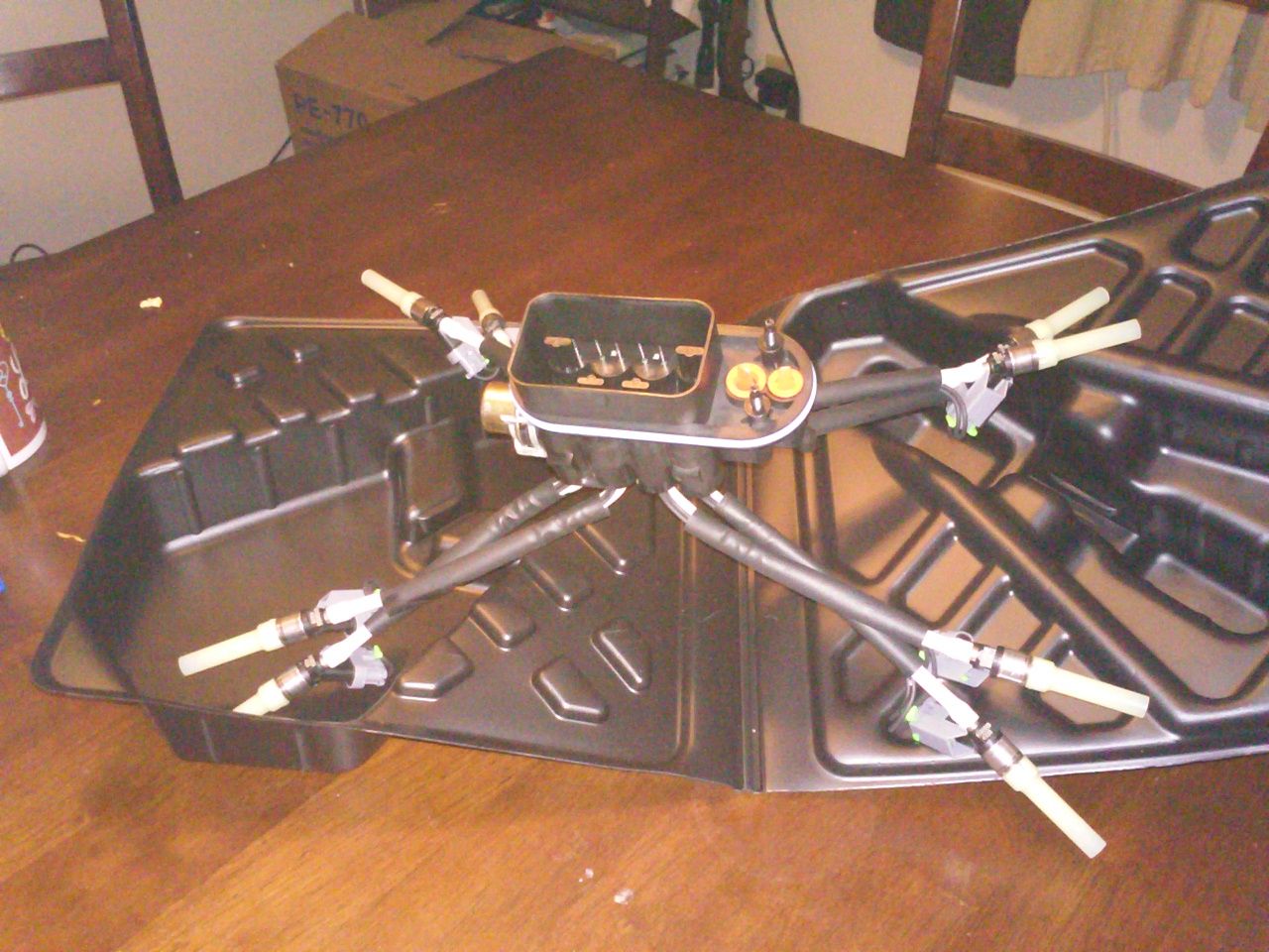

Step 2: Heat the Tubing and Pull the Poppet Out.
With this step be patient, you need too heat the black tubing right at the poppet to just the right temp. the safest way to do it is to dip the  last inch or two in a pot of boiling water for about a minute.
As soon as you pull the poppet out of the water start to work it out of the tubing with two pairs of pliers.
Be very careful not to scratch the poppet or break the hose. Don't squeeze to hard on the poppet or you will crush it an then you might as well buy the MFI kit cuz the cost about $80.00 a piece.
You will only have a few second at a time to work the poppet out before it needs to go back in the pot. Be gentle and it will come out.
If you are using a heat gun it only takes a few seconds to work it out, but if you over heat the tubing it will become brittle and increase the chance of making your problem much worse.

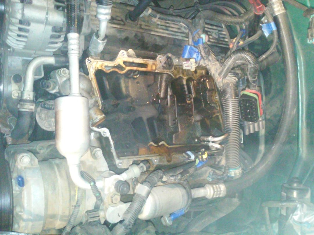

    Question 2 years ago
    I did a timing chain ..oil pump...and new lifters..on a99 surburban v8 vortect..and cleaned everything that came off the engine including the plenum and I'm very (O C D) and now I'm getting Cyc 6miss fire could I have caused the injector feed line to have come off of possibly caused it to clog up with contaminant
