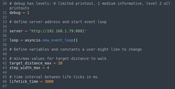

  • Should you have both python 2 and python 3 versions installed on your computer please use: python3 ./Robi_Ui.py
  • The robot controller receives an IP address from the WLan router. If you set the WLan router to always assign the same IP address for the robot controller, you can program this address as default, which avoids that you have to enter the IP each time you start the WebUI. Open file Robi_Ui.py with your editor, find the line starting with server =(see picture) and overwrite the IP address (do not change the port).
  • Make sure the computer and the robot controller are in the same network (sub-net).
  • In the same file Robi_Ui.py, a few lines above the server IP setting, you can change the debug level. Find the line starting with debug =(see picture). By default it is set to 1. If you run into errors you can set it to 2 to get full debug output. When you are ready to use the WebUI you can set it to 0 to minimize the debug output. Debug information is printed to the console window from which you started the WebUI.

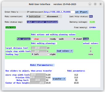

Step 3: The WebUI Sections and Typical Usage
The WebUI contains three sections indicated by different background colors.
Please refer to the attached picture.
  • Connection and Status (grey background color)
Contains the basic functions to manage the connection to Robi's web server. You can enter Robi's IP address (Robi received from your WLan router) and the port. By default the port is 8081.
The button initialize establishes the connection to Robi's server and initializes the robot controller, disconnect closes the connection to the robot controller. The field Robi status msg displays the status received from Robi. There are fields to display Battery voltage, free memory and the http status of the last request.
  • Walking planning and actions (green background)
Contains the functions to set up the walking planning values using sliders. You start actions using radio buttons. Status of the walking enging is displayed right after the radio buttons.
Walking planning values are transferred to Robi by pressing the load values button and in the last column the actual values stored in the robot controller are displayed. Remark: Only the actual values are used for calculating a walking pattern.
  • Robi Parameters (white background)
Contains sliders to adjust the parameters used for walking planning. The button transfer sends the parameters to the robot controller.
The last column Robi parameters displays the actual parameters stored in the robot controller. Remark: Only the actual parameters are used when calculating a walking pattern.

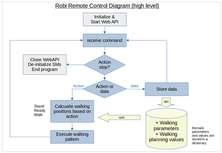

The high level flow diagram of the robot controller is attached here for your reference.
  1. Initialization: Power up the robot to start the robot controller. Start the WebUI (see Step 1) enter the correct IP adress and press initialize. The connection to Robi is established and Robi should stand upright.
  2. (Optional) Load the parameters to Robi by pressing the load values button. The parameters depend to a high degree on the hardware, adjust the parameters as needed. Default values are transferred during initialization.
  3. Set walking planning values: Use the sliders to set the target distance Robi should walk and the width of a single step. Press the load values button.
  4. Actions are triggered by pressing one of the radio buttons. The same radio button, esp. walk, can be pressed multiple times to repeat the action.
  5. ready: moves the CoM down to the position for walking
  6. walk: triggers the calculation of the walking pattern and starts the walking engine, Robi will walk the number of steps to make the target distance.
  7. stand: move Robi to the upright (resting) position.
  8. stop: de-initializes the servos and stops the robot controller
  9. Disconnect: stops the WebUi's lifetick. Remark: Disconnect will not shut down the robot controller. You can press initialize again to connect.
  10. Close the program by pressing the button (x) at the top right corner of the window.

Step 4: How to Use Connection and Status
Connection and Status functionality:
Connection functionality:
  • IP address:port Enter the IP address the robot controller received from your WLan router. By default the port is 8081. To activate an IP address entered press the button set IP:port.
  • The button initialize establishes the connection to Robi's server and initializes the robot controller, which results in Robi standing up straight. Caution: this will move Robi's servos to the neutral position right away. Make sure the servos can move the legs freely (not blocked) and Robi does not fall to the floor while initializing.
  • Disconnect will close the connection to Robi and stop the life tick. A disconnect will not impact the robot controller. When closing down, it is good practice to use a stop action to shut down the robot controller before disconnecting. Remark: As long as the robot controller is not shut down, initialize can be used to re-connect.
Status fields:
  • The field Battery voltage displays Robi's battery voltage (if you did implement this in the hardware). This should be monitored while Robi is in use to avoid depleting the battery below 3.3V (see your batteries specification).
The background color of the battery voltage field will be set to indicate the state of charge:
  • green for battery voltage > 3.85V ---> charge >70%
  • yellow for battery voltage between 3.85V and 3.6V ---> charge between 70% and 50%
  • amber for battery voltage between 3.6V and 3.3V---> charge between 50% and 20%
  • red for battery voltage below 3.3V ---> charge below 20%
Remark: If you power the Rp2040 picoW board using the USB connection, the battery voltage will show VSYS of the pico board instead of the battery voltage.
  • The field free memory is implemented to monitor RP2040's memory. This is not critical when running the robot controller only, but additional functionality (e.g. voice controlled commands, gestures, speech) might consume substantial memory.
  • Robi status msg displays the status, warning, error messages received from the robot controller
  • Life tick: The WebUI sends a GET request every ~3 seconds to request status from Robi. Robi returns battery voltage, walking status, free memory, walking action status to the WebUI and toggles the onboard LED. The corresponding fields are updated with data received. Life tick period can be changed. Open file Robi_Ui.py with your editor, find the line starting with lifetick_time =(see picture in Step 1: Installation) and enter the time in seconds (default is 3s).
  • If you want to use an "external" LED, connect the LED (with a ~300 Ohm resistor in series) to a free GPIO port and update the file cfg.py of the robot controller, where the Pin for the LED is defined. Find line starting with pico_led = and replace the string "LED" with the number of the GPIO pin you use.

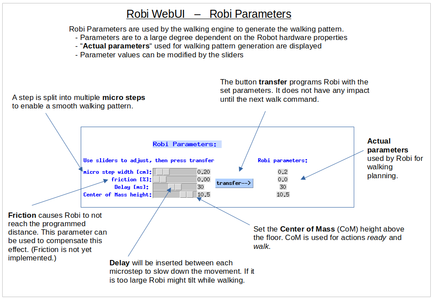

Step 6: Setting the Parameters
Parameters:
Parameters can be used to optimize the way how Robi walks. Additionally most of the parameters depend on the robot's properties, such as leg length, the max and min angles the servos can move a limb, the speed of the servos and many more. Start with the default values and then optimize each parameter step by step.
micro step width [cm]: As explained in the instructable Poor man's bi-ped Robot ControllerStep 5: Walking Pattern Generation, a step is split into multiple micro steps to enable a smooth walking pattern. A good range is 0.2 to 0.5. Divide step size by micro step width and you get the number of micro steps executed to make a full step. In general: Smaller micro steps make for a smoother walking pattern, but take more time to execute, which means Robi is on one supporting leg for a longer time. If Robi tilts too much while walking slightly increase the micro steps.
friction [%]: Friction (too much or not enough) causes Robi to not reach the programmed distance. This parameter can be used to compensate this effect. (Friction is not yet implemented.)
Delay [ms]: Robi is walking with one speed only, which typically is pretty fast. To allow for speed adjustments and slower movement the delay will be inserted between each micro step to slow down the movement. One other use case: Depending on the torque of the servos and the inertia of the robot hardware, a delay might be needed to allow the servos to reach their programmed position for each micro step. See a Remarks below for more on walking speed.
CoM height: The height of the center of mass (CoM), which is used during walking. The ready command will move Robi to CoM height set by this parameter. Typical ranges are 9.5 to 10.5. The upper and lower limit of the CoM height is dependent on the hardware and is set in module robi_def.py.
Remarks:
The basic Idea is to optimize each parameter with the goal to make Robi walk smooth. When you optimize, do it with one parameter at a time, as the parameters impact each other to some degree. For example if you change the CoM height you might need to adjust the micro step width and/or the delay. My experience shows that there are different sets of parameters which lead to a smooth walking execution. You get sets of values [single step width, CoM, micro step width, Delay] for smooth walking execution.
There are many ways to manage walking speed. E.g. to walk slower you can:
  • decrease the single step width, which results in more steps to reach the target distance
  • reduce the micro step width, so more micro steps are needed to make a single step
  • increase the delay, which slows down the speed for a single step
In a similar way you can increase speed by increasing single step width or micro step width or decrease the delay.
As already noted above, the basic Idea is to get sets of parameters [single step width, CoM, micro step width, Delay] for smooth walking execution. Play around a bit and have fun to see Robi walking!
