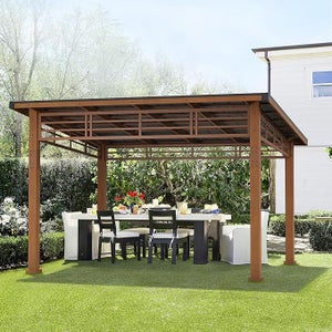

When considering the idea of a shade structure for a day at the beach, I imagined hot, sunny Californian days with summer events like local concerts, casual days in the park, farmer’s markets, cultural fairs, and several other community events. As a Californian high schooler with finals ending and summer break starting, a cool place to sit at these events sounded ideal, and so a solution came to mind: a common shade spot, a garden pavilion like the ones often used at parks and backyards.
My project addresses accessibility, sustainability, and structural aspects of a shady spot on days where the summer heat stays high and where urban areas lack green infrastructure. For research, I looked for materials that are easily repurposed, easily sourced, and environmentally conscious. I also looked for structures that were easy to put together. Here, I looked at different examples of garden pavilions and eventually decided on a canopy pavilion using rectangular shapes for easy set-up and bamboo wood for sustainable use. Not only useful for Californian weather, but for any hot populated area, my pop-up garden pavilion acts as an aesthetic, biophilic, and cooling space during the summer.

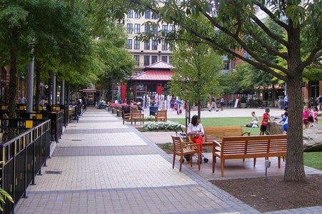

Specific locations include city parks like Central Park, Golden Gate Park, or local community parks. More general sites could be rooftop gardens, elementary schoolyards, outdoor concert venues, college campuses, farmers markets, and town squares, or just anywhere that could benefit from a shaded space during summer events.

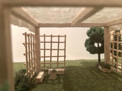

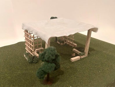

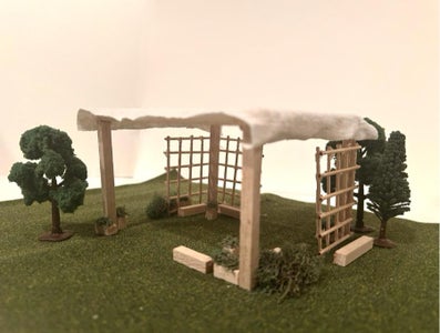

Step 5: Physical Model
First, I started by gluing the grass paper to a foam board. Then, I cut the basswood sticks into two four-inch ones, two five-inch ones, four three-inch ones using a utility craft knife. After, I glued the planks together in a 4inx5in rectangle, then added a height of 3 inches on each edge of the rectangle. Next, I started on the panels/trellis. To create one, I cut 6 toothpicks into 2 inches and hot glued them to three toothpicks. I repeated this process three times. I also used the cutting mat to evenly space the toothpicks. Then, I cut an old white rag into a square to fit the top of the pavilion while allowing for some slight hang off the sides. However, I realized a more structured approach might be necessary, so I added another beam for support, creating two rectangles for the ceiling. I then hot-glued all of these components together: the trellises and the pavilion frame. Finally, I started on the decorations: I created four one-inch benches and various planters using extra basswood sticks. I glued on small bits of artificial moss and compressed them to become small plants. To add greenery, I added artificial trees and bushes.
