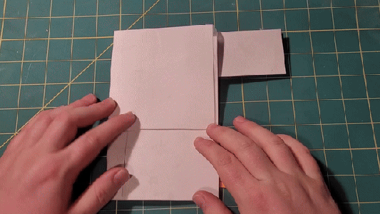

Step 9: Cut Slit Near Bottom of Card
Now cut a slit near the bottom of the card where you want the movable football to go. I cut it right where the card bends and unfortunately my razor blade was dull and ripped the paper as you can see in the 3rd picture. So make sure your blade is sharp or just cut it from the back to begin with.
Step 10: Cut Thin Cardboard Strips
We need at least one thin cardboard strip to attach to the card and hold part of the football. I cut three because I was going to do the goal posts but then I only ended up needing one. From here on they will be referred to as strips.
Step 11: Cut Long Strip of Thin Cardboard
Now cut a really long strip of the thin packaging cardboard this will become the pull tab to make the football move. It can be too long and cut down to size later, mine happened to be the right length so I didn’t need to trim it later. From here on this will be referred to as the tab, short for the pull tab.
Step 12: Glue & Fold Strips Down
Now fold the end of the strip just enough to put glue on it and then glue it down to the card, you want it a little to the right of the slit we cut for the tab. I went roughly half an inch from the slit and lined it up with it. I also ended up having to put a piece of tape over the strip later to hold it down to the card. My glue wasn’t entirely dry when I started working with it. Also a good idea to reinforce the bend with some tape.
Step 13: Insert Tab Through the Slit
Now insert the tab through the slit cut earlier and make it go the same height as the strip. I folded the tab at the back of the card but I would hold off so you don’t have to refold it later like I did. I also drew an arrow on the pull tab which is optional but makes it more obvious. I then taped it so the marker wouldn’t just come off since I drew it on the glossy side of the package.
Step 14: Cut Angle Out of Tab & Strip, Also Cut a Small Strip
I then cut an angle out of the tab and the strip so the football would be at an angle rather then just straight up and down. I also cut one of the other strips down to a small strip the same length as the gap between the tab and the strip.
Step 15: Tape Small Strip Onto Tab & Strip
Now tape the small strip you just cut out onto the tab and strip. I put tape on both sides so it would be reinforced as this is going to take most of the bending motion from the pull tab. This small strip is what the football will be held up by. I also put some tape on the strip and card because it pulled off while I was taping the small strip on.
Step 16: Glue & Cutout Football on Thin Cardboard
Now glue the football to a piece of the thin cardboard and cut it out. Just go slow and slowly turn it as you cut to match the shape of the football.
Step 17: Glue Football to Small Strip
Now glue the football to the small strip which should now be taped onto the tab and strip. I centered it on the small strip and only put glue where it would actually touch the small strip as the football is longer then the small strip is. Let it dry or you will be gluing it a second time like I ended up having to.
Step 18: Make Card Shut Flat & Fold the Tab
Now assuming you didn’t do what I did and already fold the long tab now is when you want to pull it out enough for the card to shut flat and then fold it. If you did already fold it like I did its no problem we just refold it and then reinforce it in the next steps. Mine was just barely off by probably less then a centimeter.
Step 19: Reinforce All Cardboard Folds With Tape
I noticed as I folded the card and tested the pull tabs that all the areas where the cardboard is bent were starting to tear. So take some of the tape and reinforce all the edges so the card can be opened and used multiple times.
Step 20: Reinforce Tab If Refolded
If you had to refold the long tab like I did then cut a small strip of the thin cardboard again and tape it over the old fold. Ignore the cut in the tab for now that is the next step.
Step 21: Cut Small Slot Near End of Pull Tab
Now to stop the pull tab from being pulled too far out cut a slit near the end and a small strip of cardboard to put through it and tape it into place. This also holds the tab against the card instead of having it fly around. I ended up having to extend the slot two times so make it a little longer then you expect, or just extend it with the scissors like I did.
Step 22: Test & Extend Slot in Tab
Now test the motion of the football by pulling the pull tab and if doesn’t go as far as you want extend the slot a bit with scissors. Mine was getting stuck straight up and down which isn’t what I wanted. I wanted the football to go from one end of the field to the other.
