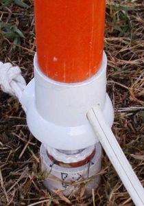

- A ball&socket plastic water shut-off valve was modified into an articulated ball&socket base for the mast.
The setup of the portable generator and mast is now greatly simplified by the ball&socket base:
- A plastic stake is fully driven into the ground, for the mast. The stake is then carefully pulled out and the special, custom made ball-topped mast stake is pressed in its place.

- The socket base of the mast is snugged onto the ball of the ball-topped mast stake.
