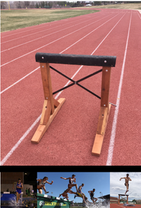

The Steeplechase is a Track & Field event contested at the Olympics and World Championships. Its a 3000m (Almost 2mi) track race with 4 large non-moving barriers and 1 Barrier followed by a water pit per lap. Its typical for steeplechasers to hurdle the "flat" barriers and step on the "water" barrier to clear the water pit.
Most of the time steeplechasers train with regular, one-lane width, hurdles that are easily knocked down to avoid tangling with the unmoving, weighing something like 200lbs, barriers which also span 4+ lanes.
It is important however to practice stepping on the barrier to emulate the water pit and occasionally hurdle something more representative of a barrier. Some tracks don't have steeplechase equipment or find it inconvenient to use full length barriers as they take up half the track width.
Shown in this instructional is a one-lane, collapsible, practice barrier easily constructed from materials found at your local hardware store.

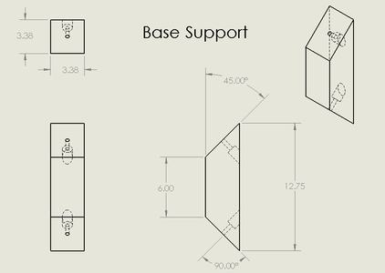

Step 1: Schematics
The schematics above show the information for the parts of the barrier. In all you will make:
2 - Base
2 - Uprights
4 - Base Supports
1 - Top Piece
2- Cross Pieces

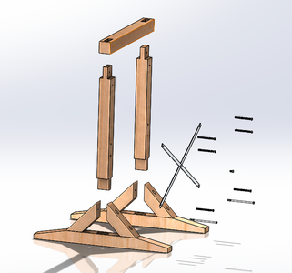

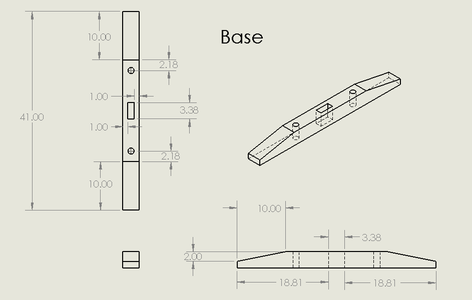

Step 4: Assemble the Base
After completing the major cuts and forming the mortise and tenons you are ready for assembly and drilling.
  1. Slot the base and uprights together
  2. At this point there may be a little wiggle between the upright and base pieces that will be controlled by the 45 degree support pieces. Make sure that everything is square before attaching the support pieces
  3. Attach the support pieces on either side of the upright by countersinking 4 woodscrews through the support piece and into the base piece.
At this point the upright should still be able to slide out of the base but be supported forward/backward by the rigidly assembled base.
*Note: I originally designed this to bolt the base supports to the base piece as well as the upright and the CAD reflects that. In the actual assembly I just attached using the 4 countersinks.
Step 5: Bore the Base-to-Upright Hole
With the base and upright slotted together bore a 3/8" hole through all the pieces.
Use a 3/4" bit to countersink 1" deep.
An 8"x3/4" bolt can now be placed into this hole securing the upright to the legs yet still allowing the assembly to break down for transport or storage.

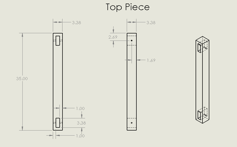

Step 6: Drill Holes for the TopPiece-to-Uprights
Slot the Top Piece onto the uprights. This thing is starting to look real!
Drill holes at the locations shown in the diagram.
Two 5" bolts can now secure the top piece to the legs.

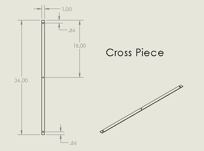

Step 7: Create the Cross Piece
The Cross piece is created from extruded aluminum. It doesn't carry any of the weight when you step on the barrier but just keeps the uprights and top piece square so they can take the loads during use. Having an Aluminum piece here also keeps everything much lighter.
  1. Cut the aluminum to the correct dimensions as shown in the schematic
  2. Bore holes in the center and ends
  3. Drill holes in the uprights
  4. 4x5" bolts secure the cross piece to the uprights

Step 9: Paint/Stain Pieces
Paint and stain the pieces to you desired finish.
Go get Fast!
