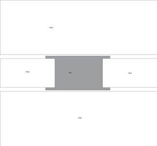

Step 1: Cut Your Vinyl and Pvc Window
I made this blanket roughly 80" x 92". I pieced the top in 3 sections.
The two largest measure 32 x 92, these follow the top and bottom and I filled in with two skinny pieces
@ 17" x 30 and set the pvc piece between them. This is based on 1/2 seam allowance, except for around the center pvc frame, where I will double up the seam allowance at 1 ".
Minus the pvc section, you'll want three pieces of grey vinyl cut and assemble as well, so get stitching!
