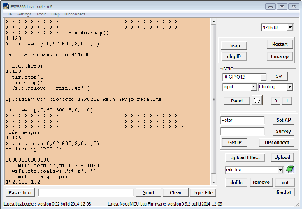

    Thanks for your code! The interupt.lua seems to work, I get a Prowl message on my phone if i pressed the button. But only if i do it with "dofile" in LuaLoader. If i Press "dofile" for the init.lua it says " lua: init.lua:5: tmr 4000 does not exist " how can i fix this to run it standalone ? Tank you :)
    0
    Werquinx
    Werquinx
    Reply 7 years ago on Step 5
    You are using a newer version of the LUA firmware which now provides several timers ! Hence you need to change :
    tmr.alarm(4000, 0, function() dofile("interupt.lua") end)
    by :
    tmr.alarm(1,4000, 0, function() dofile("interupt.lua") end)
    where 1 would be using timer 1 ...
    I hope that helps.
    0
    giwipod
    giwipod
    Reply 7 years ago on Introduction
    Thank you! Now it works!
