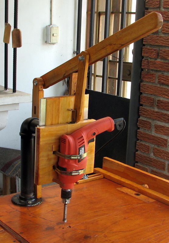

Step 2: Hand Drill Press
The drill press is mounted with 2" pipe and flanges......works very well and is very sturdy.....the wood is oak from a broken oak folding chair.......the slide mechanism is made with aluminum picture frame molding which happened to interlock when put back to back.......I would use drawer slides if I had them.......would be much easier......the drill is mounted to the board with clamps......the block of wood behind the drill is a wedge for adjusting the angle.......The drill works amazingly well and is easily removed.........

9 years ago
its great.. but i need to knw smthng that the tie by which you set the drill mechine,what's it's name??? and where i can get it??
Reply 9 years ago on Introduction
Hose clamp......
Reply 9 years ago
thanks a lot...
