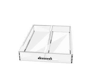

When you have a good idea, be sure to draw it so you won't forget it! I drew a rough sketch of how I wanted it to look. I didn't include dimensions in this drawing but your design will go so much faster if you have those dimensions handy. I really like JON-A-TRON's advice in his class that you should "Measure twice and 3D print once". In fact, for this project, I triple checked the measurements so I would make sure to get them right. I would highly recommend also checking out the "Invention Class" where I learned to develop the skills/inspiration I've shown you here!
Like I mentioned before, I added a couple of features to design that would be nice to have. One that I didn't mention before was the elevated corner so that you will never have to worry about lining up the papers you are tracing with because the corner will match them up perfectly for you! I did end up using only two shelves instead of 3 for simplicity's sake but everything else is exactly the same. Now its time for the 3D printing!

I have included three STL files for this project. So in total, you have the top drawer, bottom drawer, and the box. I designed the box so the drawers would just slide in and out without guides but weren't loose enough to fall out if tipped on the side.
Once you've printed out the box, you can either prime it and paint it, or you can just take it as is. For me, I didn't want to paint it because of the additional steps involved it also has no effect as far as the functionality of the product itself. However, if that is something you are interested in, by all means paint away! :D Included in the design are also some notches that protrude out slightly on the top to be able to sustain the 5" x 7" pane of glass.
Go ahead and slide the glass pane on to the top of those notches. It should be flush to the top of the box. Once you check that everything fits properly, it is time to include the lights inside the box so that we can start tracing.
