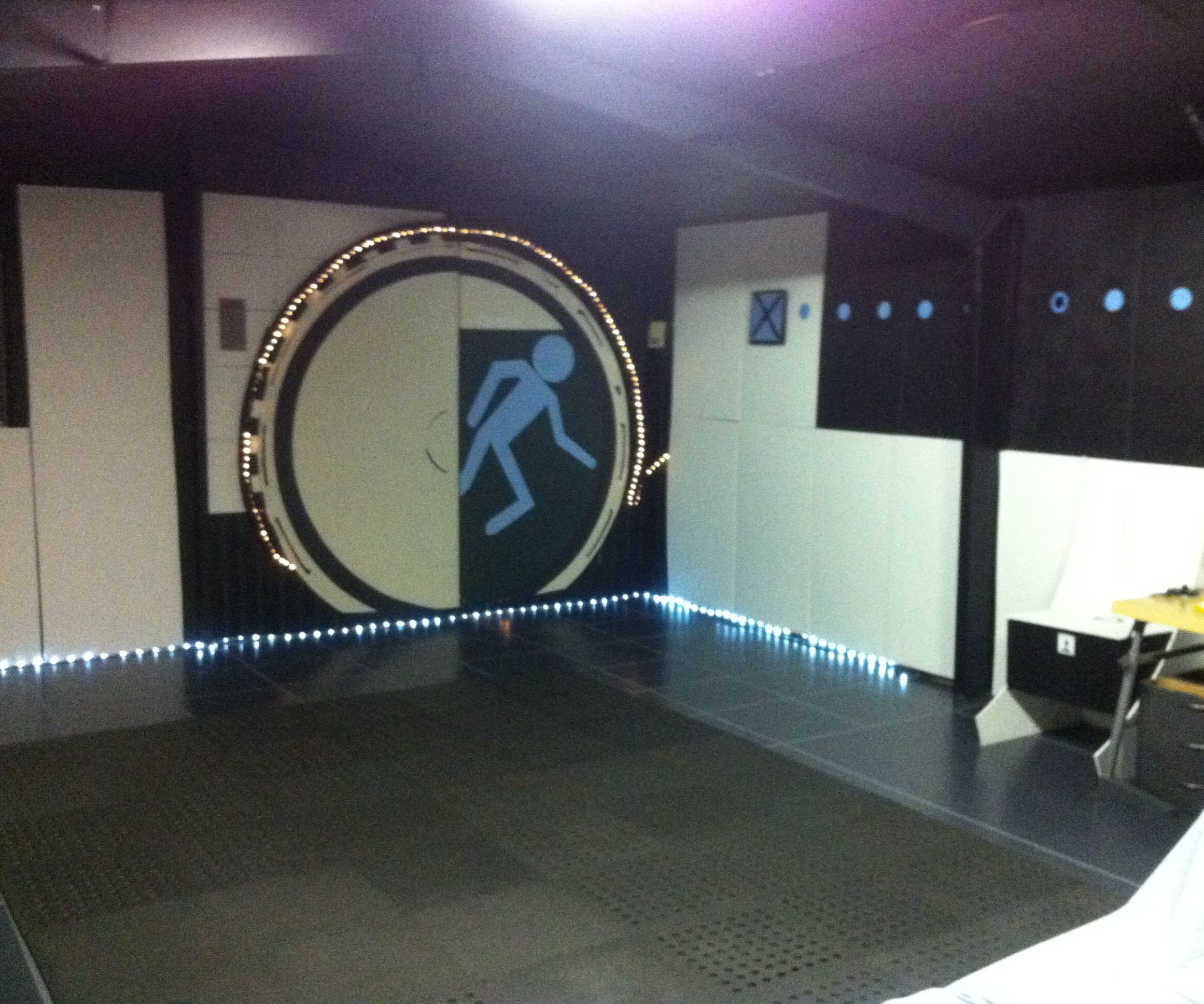

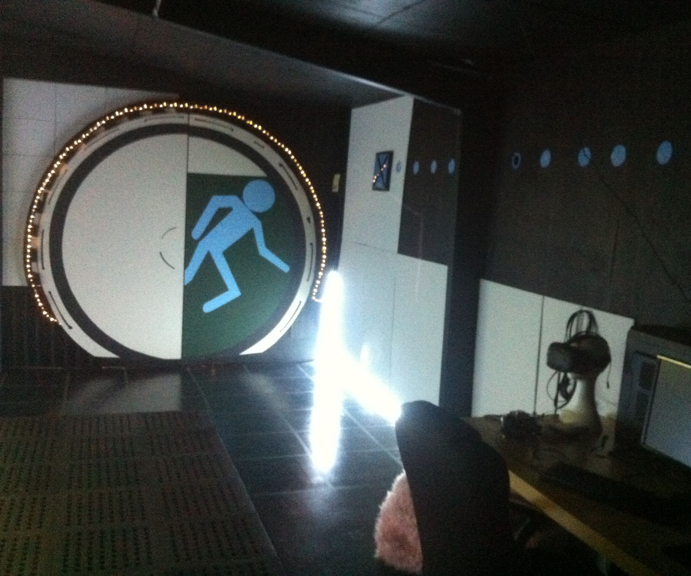

I built a Portal 2 Themed VR room when I was getting my HTC Vive and when I had finished that I decided to add some Portal themed props to enhance the room. First on my list was a button pedestal and I found one that had been done on Instructables previously you can see here . Which I followed but changed quite a bit as some of it was not suited for what I was after. The button Pedestal I was after was more of a prop and did not need a working button and I changed the materials used and the base to the project.
