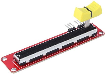

5 slide potentiometers
These pots have 2 sets of pins for weening and/or waxing readings... for this project, I only used one set. I assume the need for dual-direction readings would be useful in audio applications?
So they are wired using one set of pins per pot:
  1. Each ground pin from the 5 pots are wired together and then wired to the input connector
  2. Each VIN pin from the 5 pots are wired together and then wired to the input connector
  3. Each Data pin from the 5 pots is wired to the input connector
