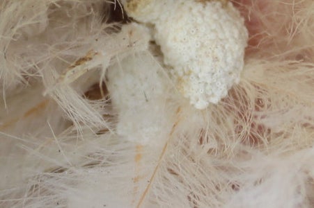

Lice are insects. In appearance they are small, caramel-coloured and shiny also thankfully, visible to the naked eye (1 to 3mm in length). (PHOTO ABOVE)
short life span, which in adult form, is from 2 to 3 weeks
maturity within a few days
and are prolific egg layers (50 to 300 eggs),
these the female attaches to the base of the feather shafts in clusters, known as 'nits' (PHOTO ABOVE)

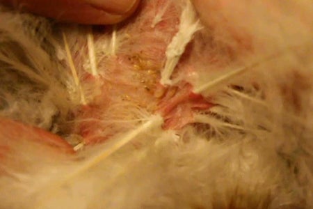

feed on blood, where it has already emerged from punctured skin or damaged feathers.
In my experience, when in large numbers they can also cause dermatitis around these same areas.

Lice gather and lay their eggs around the places the bird would find difficult to groom or reach. There are various factors affecting this ability - both physical and emotional. To identify if your own bird comes into the category of a bird at risk, please check for more details in my article here
In the main however these include:
the area around the vent,
under the wings at the top,
back of neck just above the wing,
breast,
top of the head and if they have one, crest.
