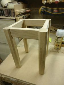

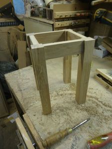

Step 3: Legs
I ripped what was left of the worktop into 40mm wide strips, then fed it through the planer/thicknesser to take off the nasty surface to get them square and even. I selected the best bits for the legs and cut them to length (300mm) on the mitre saw.
I made the rails (140mm long, 45mm wide) from a piece of scrap oak I had kicking about, on the table saw & mitre saw.
I chose to use mortice & tenon joint, because they're strong and sexy. After marking out where the mortices would go in the legs, I cut them using a morticer. You can do this with mallet, chisel, and a great deal of care if you don't have a morticer. The tenons where cut using a rebating bit in the router.
After a cheeky test fit to make sure everything was nice and snug, I gave the appropriate edges a bold chamfer using the router.
A few clamps and some glue and it was ready for some sandpaper love, and a few coats of varnish.
