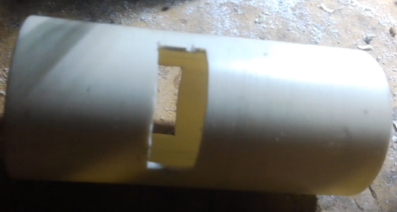

Step 1: Making the Body

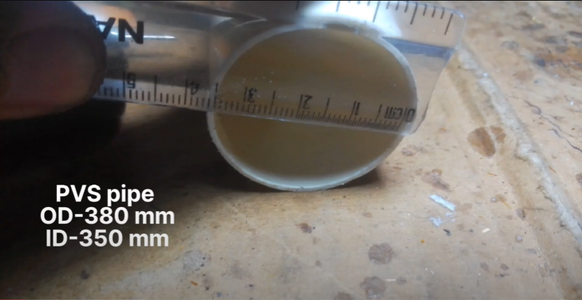

To make a strong body I used 3.8 cm plastic tube ID and OD mentioned in the image.
Two piece is required one for the handle and other one is for the motor holder.
On the top of the handle pipe I sabded with a sand paper to make a "U" shape to joint the motor holder with it.

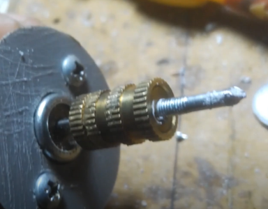

A flat plastic piece with three holes two for motor screws and one for motor shaft is drilled as in Image 1.
Motor is screwed with two screws Imagfe 2.

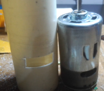

Now insert the motor insid the pipe Image 3,4....(Befor do that make some holes to pass air if your motor has breathing holesImage 5).

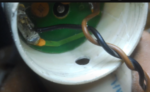

Make a small hole to pass motor wire to handle image 6,7.

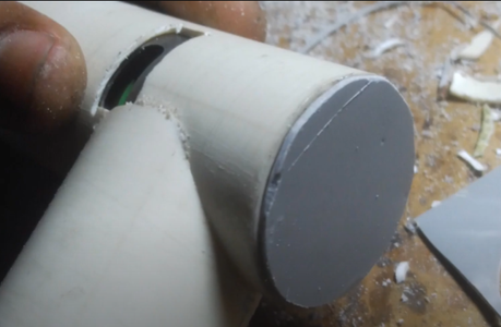

Cut i circular piece of plastic sheet and cover the motor pipe back side image 8,9.

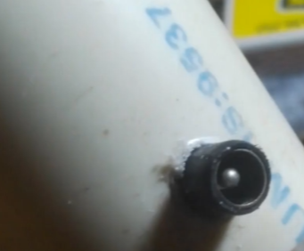

Step 3: Connection

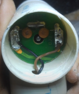

Motor has two wires following two ceramic capacitors.
Connect motor positive+ to one side of switch and Motor negative- to power socket negative-.
Then connect Other side of switch to power socket positive+ and make sure there's no short circuit and close the handle bottom with Plastic sheet.
