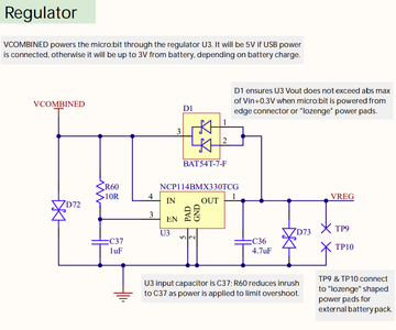

Schematic
- The V1.3b schematic shows the low current regulator being used for the USB power only. The regulator is a feature of the microcontroller used for USB interfacing (NXP MKL26Z128VFM4) .
- The V2.2.1 schematic has an interesting use of two diodes in series for the circuit protection on the battery.
- The 3V pad on the V2 is always regulated, the V1 is only regulated when USB powered.

Some observations.
- Three rechargeable batteries should not be used despite their nominal voltage of 1.2V as three can exceed the recommended maximum voltage of 3.6V. The voltage in the testing was 1.28V per cell for batteries that were charged six months ago and had been used a little. The voltage will be far higher for a short period if they have just been charged and are used immediately.
- The 3V pad on the V2 is likely to be via the 3.3V regulator (the schematic confirms this).
- The V1 shows the schottky diode is actually 0.09V to 0.17V for these tests. A forward voltage of 0.3V is commonly used in discussions about schottky diodes but clearly it can be lower and can vary.
- The V2 voltage drop from battery to 3V pad is more than the V1 because of the regulator and the pair of series schottky diodes. It is still remarkably low due to the choice of diodes and performance of the Onsemi NCP114 low dropout regulator
- It's clearly important to test with representative loads.

- The specification is clear on the 90mA for the V1 and less clear on the 190mA or 270mA for the V2 from the 3V pad.
- The 3V pad will output 3.3V on USB power but for an alkaline battery pack it will be lower on the V1 and, based on testing, slightly lower on the V2.
- The V1 could supply more power if it is only powered via the battery connector but there's no specified value for this.
- The maximum battery voltage is specified as 3.6V but strictly speaking this appears to be a V1 only limit. The V2 has a different power design and regulates the voltage everywhere including the 3V pad although higher voltages will cause more power dissipation in the regulator.
- A GPIO current of 5mA per pin is practical on both V1 and V2 and Nordic recommend total GPIO current of 15mA on their forums.
- For any use where the V2 is required for its power features then care must be taken to avoid using an incorrect version board. The V1 and V2 boards do look a bit different but a user may not realise a V2 is required and may not notice or be aware of the differences in appearance.
- The absence of (near) 5V power on the edge connector is a limitation**.
