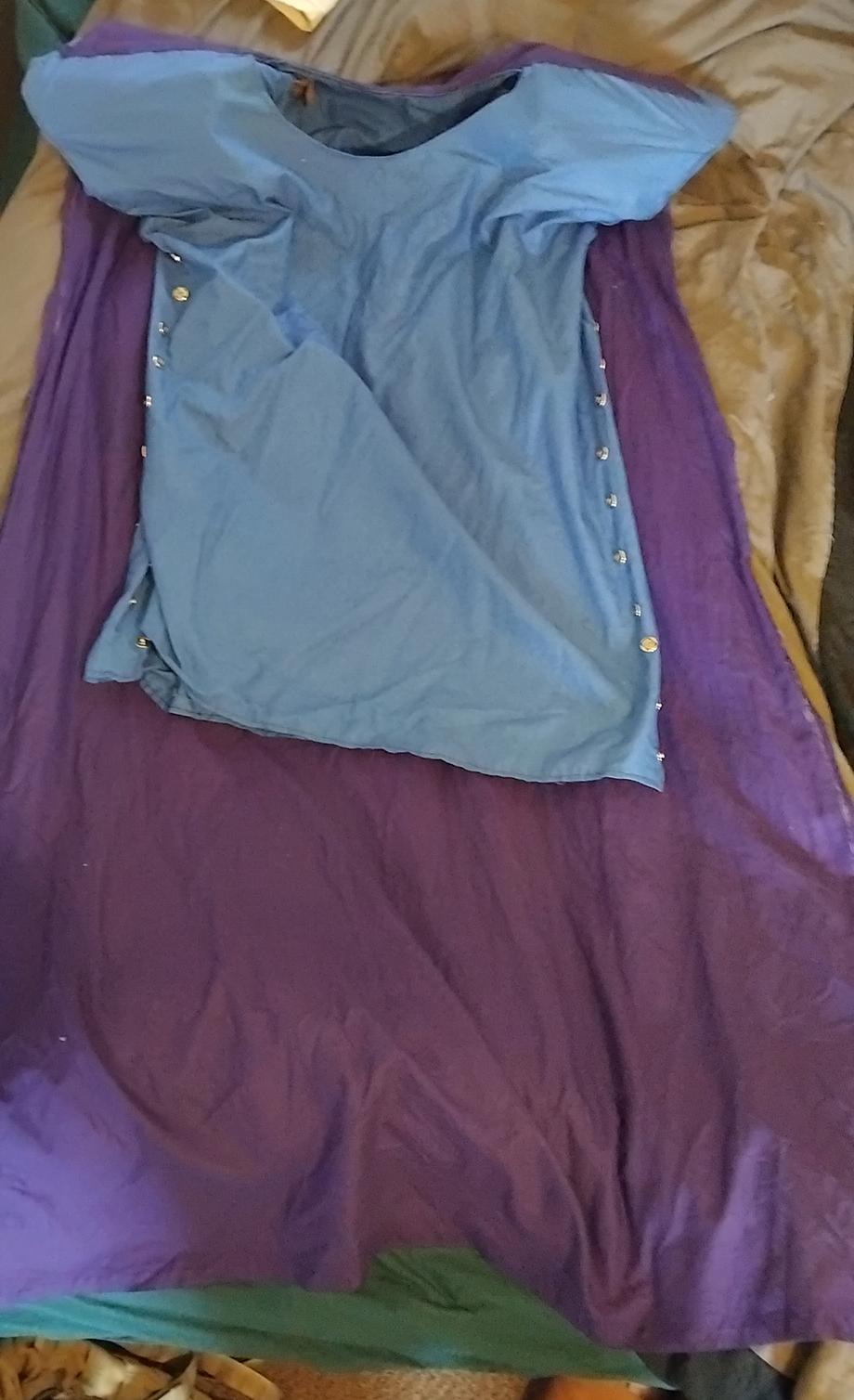

Step 4: Dress (tunic), Cape and Undershirt
It's not a dress, it's a tunic!
But it is.
This was the most time intensive part of the costume for me. If you have a sewing machine you could smash this out in a day. I hand stitched it. Multiple times because I have never made a costume before never sewn anything more than a pair of socks.
Underneath the tunic I wore a long sleeve t-shirt with gorilla fur sewn over the top. Was a little warm but not unbearable. A short sleeve t-shirt would work but the inside of the gorilla fur is very rough and might grate along skin. A full gorilla suit would have been a sauna.
Though not as technical as the hat was to make, this piece took a long time. Weeks. Literally. I had to sew, pick out the stitches then sew again multiple times on every piece. The costume was modelled on myself by myself, so I had to pin it together while wearing and hope it worked. Which it didn't. The final product was nowhere near as good as I wanted but it was good enough for a bit of fun.
The t-shirt was made to be modular. All the fur was attached by either poppers or safety pins. This meant I could remove them after the event and be wearing a plain black t-shirt. Sure, it had poppers on but these were hidden by an over-shirt. I changed in the lobby of a hotel because I only booked one night.
Step - Undershirt
A simple long sleeve black t-shirt with gorilla fur sewn along the arms.
Initially tried sewing the fur along the sleeve of the t-shirt. Which is why I bought a long sleeve. Gorilla fur is incredibly hard to sew. The thread keeps catching and it's impossible to see where the stitch lines are.
After unpicking multiple times, I decided to use my noodle. I wrapped the gorilla fur around my arm, left it a little baggy, using sewing pins to hold it in place.
The gorilla fur close to your hand will be covered by the gloves so doesn't need to be perfect or full length. The fur only needs to wrap up your arm at this point. Make sure it goes up to armpit and shoulder. Reminder you're also be wearing a tunic.
My gorilla fur arms were fitting around the armpit/shoulder area with a series of poppers (snap fasteners, 15mm) sewn on. Worked remarkably well and held up great. Not one came loose. 15mm
Once the tunic is finished, put the entire costume on and see which areas of the t-shirt need patching with gorilla fur. Will be minimal areas. By this point I was sick of sewing and used safety pins instead of poppers to hold them in place. Had the same effect; was modular for a quick change back to the train.
Step - Tunic
Brace yourself, this may make you want to quit the outfit. I found this incredibly difficult as I made everything myself. Which meant pinning and cutting fabric which I was wearing. Took a lot of time to make it fit. It still bunched and creased. It's just a little fun, deal with it. No one's expecting perfection.
The tunic is simply 2 pieces of blue cloth held together with stitching and 15mm snap fasteners. HA!
I guess the outline method to follow would be something like:
  1. Use safety pins to hollow the neckline area together, leaving an area in the middle for your head
  2. Cut a small hole where your head will poke through and try it on
  3. If the hole isn't big enough, widen it a little, always aim for too small and widen later
  4. Once your happy with the fitting, add a ton more safety pins to the neckline and shoulders
  5. Do not sew anything until completely happy!
  6. Put the tunic on then fold in the sides and use safety pins to hold them in place
  7. Try bending over and twisting to make sure the seams hold
  8. Don't leave it clown baggy, loose is better than tight
  9. Once happy with the neckline and sides, begin final stitching
  10. Switch the shoulders and neckline together, obviously removing the safety pins once complete
  11. Sew snap fasteners down the side leaving as big a gap as you see fit, maybe 6cm-7cm
  12. Put everything on and hope it fits
  13. Or unpick your sewing and do it all again (I did)
Now you have a tunic and cape. Time to finish the shoulder areas; arm holes and some sort of lightweight pauldrons. These areas rely on each other and is dependent upon your physique. Just above the poppers, the cloth starts to fold in on itself for each piece, angling itself up to create a hole. This requires cutting the fabric so do it slowly and carefully. Can always cut more, can never go back
The pauldrons, creating a pointed broader shoulder, were constructed of left over EVA foam and lots of cardboard. Loose cloth at the top of the shoulder areas were folded up, glued and snap fastened to the pauldrons.
The pauldrons became a little uneven throughout the day. I'm not sure how to make them more stable. Perhaps a strap system? If creating a single use costume like I did, this was fine. Maybe add more padding than I did
One of the poppers did come un-popped a couple of times. It didn't make any difference to the structure or fitting and no one noticed. I left it un-popped.
The cape/tunic ended up as a single piece which would easily be put on and removed by the wearer.
Added bonus; I attached the cape last and used this to pull the pauldron areas closer together, adding rigidity. If the tunic was bunched up a little more under the cape then I think the pauldrons may have dipped less.
Step - Cape
Glue is not your friend. The cape was a last minute panic for me and I messed up the seams. No one said anything, everyone was so nice.
My cape fabric came almost the perfect length. I simple folder the edges by a couple of centimeters to make them stronger and hide some wonky cuts. These were sewn up. Nothing special.
The top of the cape was then sewn to the shoulder line of the tunic. 3 rows of switches were used as I was paranoid of it becoming caught and ripped off.
Even the folder sides of the cape looked fine and held together perfectly, the insides were frayed a little. This bothered me to point where I applied a very thing amount of PVA glue around the edges to stop them fraying. They didn't not fray anymore. However the glue did become a little visible later on. Kind of wish I didn't do that.
