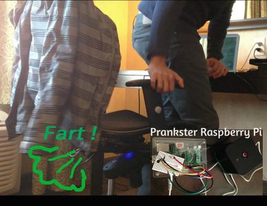

Here is a stellar April Fools' Day Prank !! for your workplace ,using a Raspberry Pi,portable speaker and a fast vibration sensor .
Watch the video above and follow the ible, and rig up your co-worker chair so that it makes fart sounds when he/she takes a seat. Modify the code attached in step 3 and record your own scary/goofy sounds.

once you run this command in a couple of seconds you are ready to test , tap the fast vibration sensor as shown in the video above and this should trigger the circuit.
And you should here a FART!! sound.

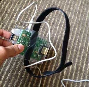

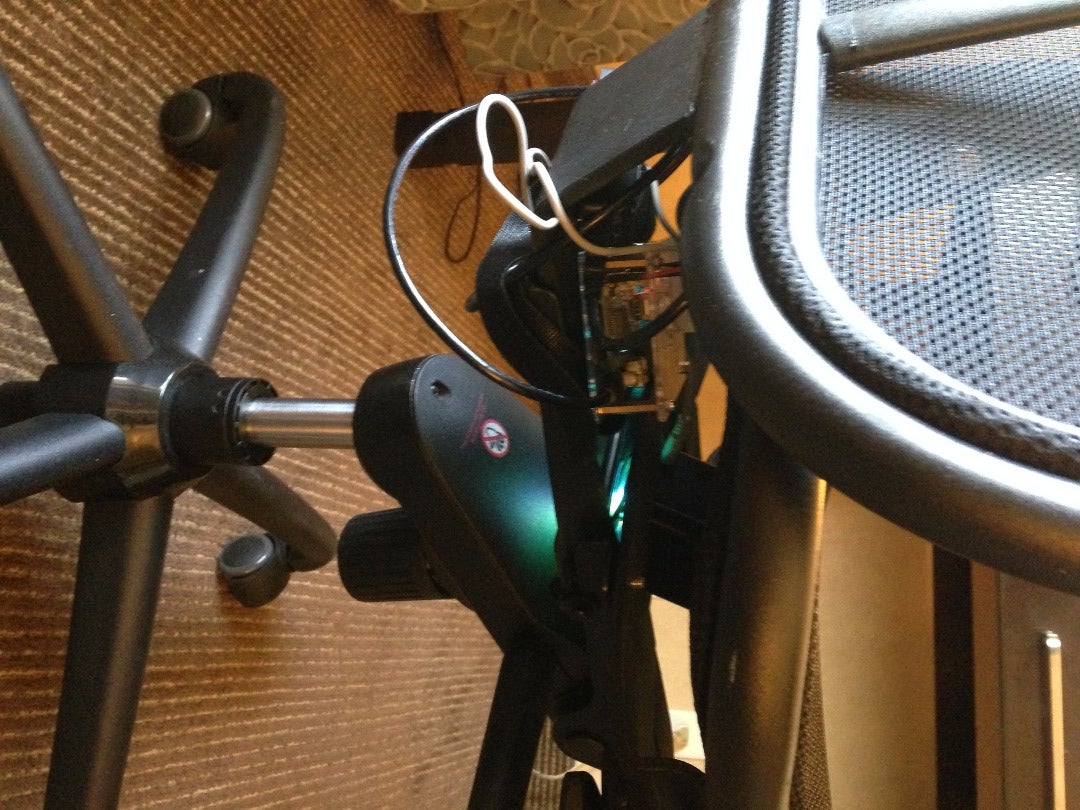

Step 7: Rig the Pi to the Chair
Now rig up the Pi to an office chair using velcro as shown in the picture above.
Most office chairs are ideal for this kind of scenario, you can put the Pi and the portable speaker between the seat bed and the gap where the chair adjustments handles originate from
