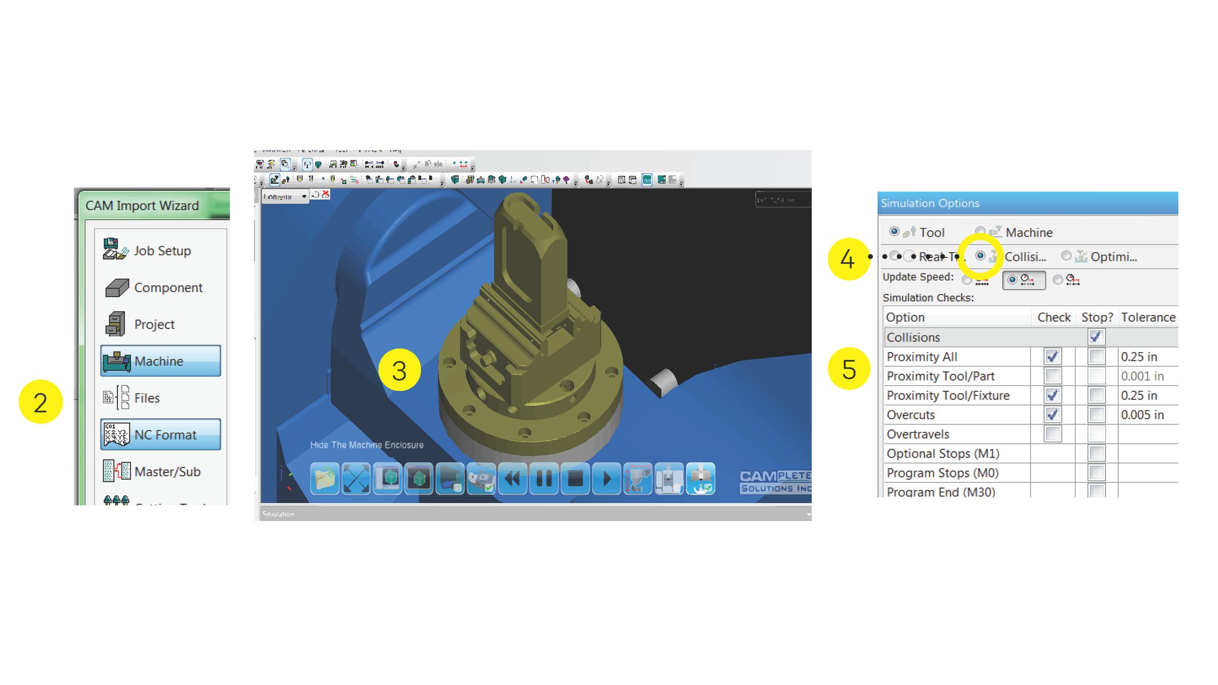

CAMplete check
Follow the steps in the CAMplete Instructable.
- Ensure that you are using the Autodesk CAM APT loader.
- Check that the NC Format and Machine Definition are correct.
- Ensure your G-code coordinate system has been translated on the Z-axes by 52 mm.
- Use Collision Checking simulation mode.
- Ensure simulation checks and tolerances are correct
- Proximity All tolerance should be no smaller than 0.25”.
- Check Status bar after simulation to ensure there are no red error messages.
- Export G-code.

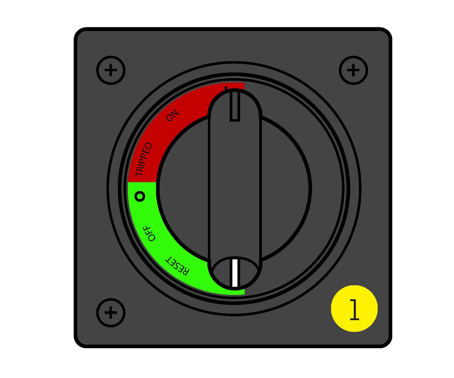

- Turn the MAIN POWER switch on the back of the machine.
- Red means that the machine is on.
- Light above switch will turn on.

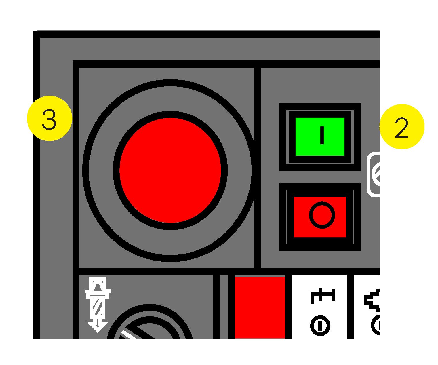

- Press the green POWER ON switch.
- Wait for the computer to boot up.
- Reset the E-Stop by rotating clockwise.
- The alarm will be deactivated.

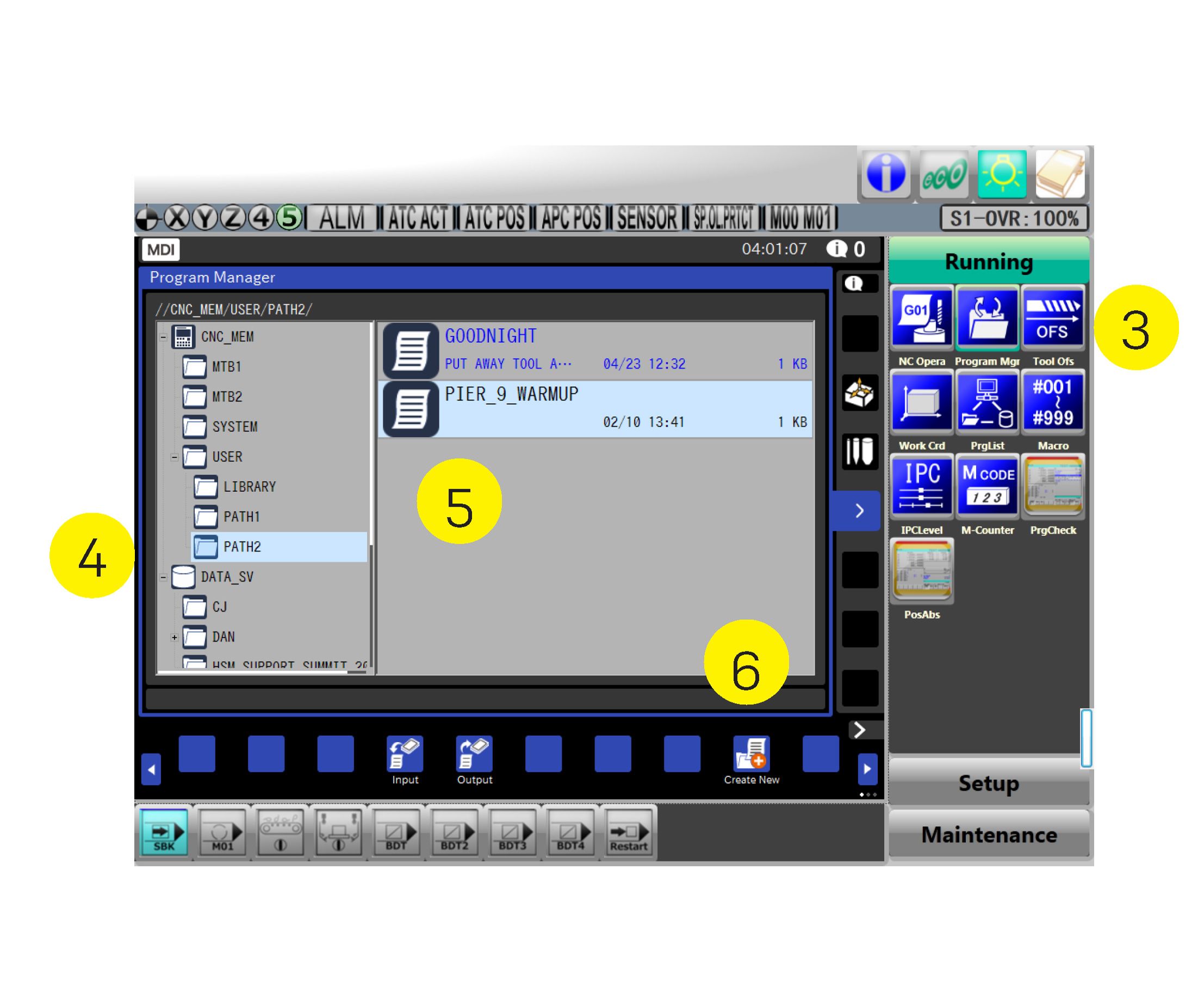

Warm up the spindle
If the mill has not been run today, you’ll need to run the spindle warm-up program.

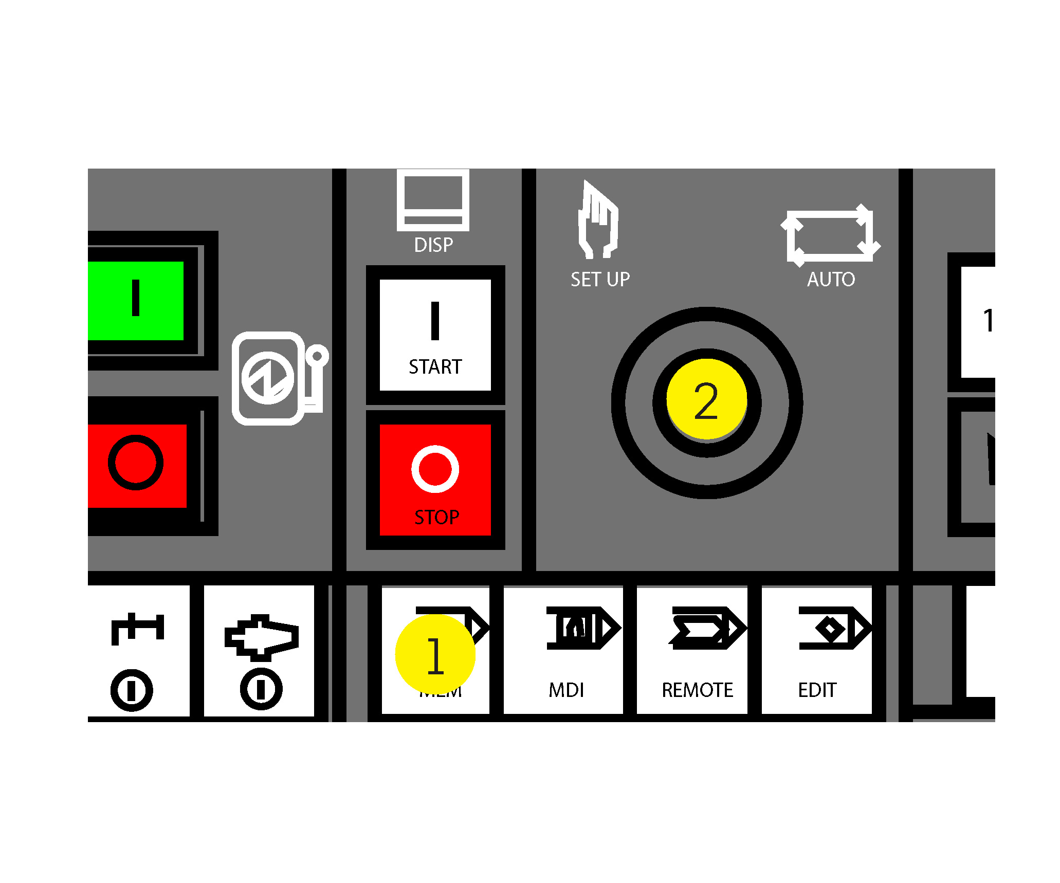

- Press MEM.
- Turn key to Auto.
- Select Program Manager under the Running category.
- Select Path 2 under User.
- Select Pier 9 Warmup.
- Select Open.
- Press CYCLE START to run the program.
- This takes about 10 minutes.

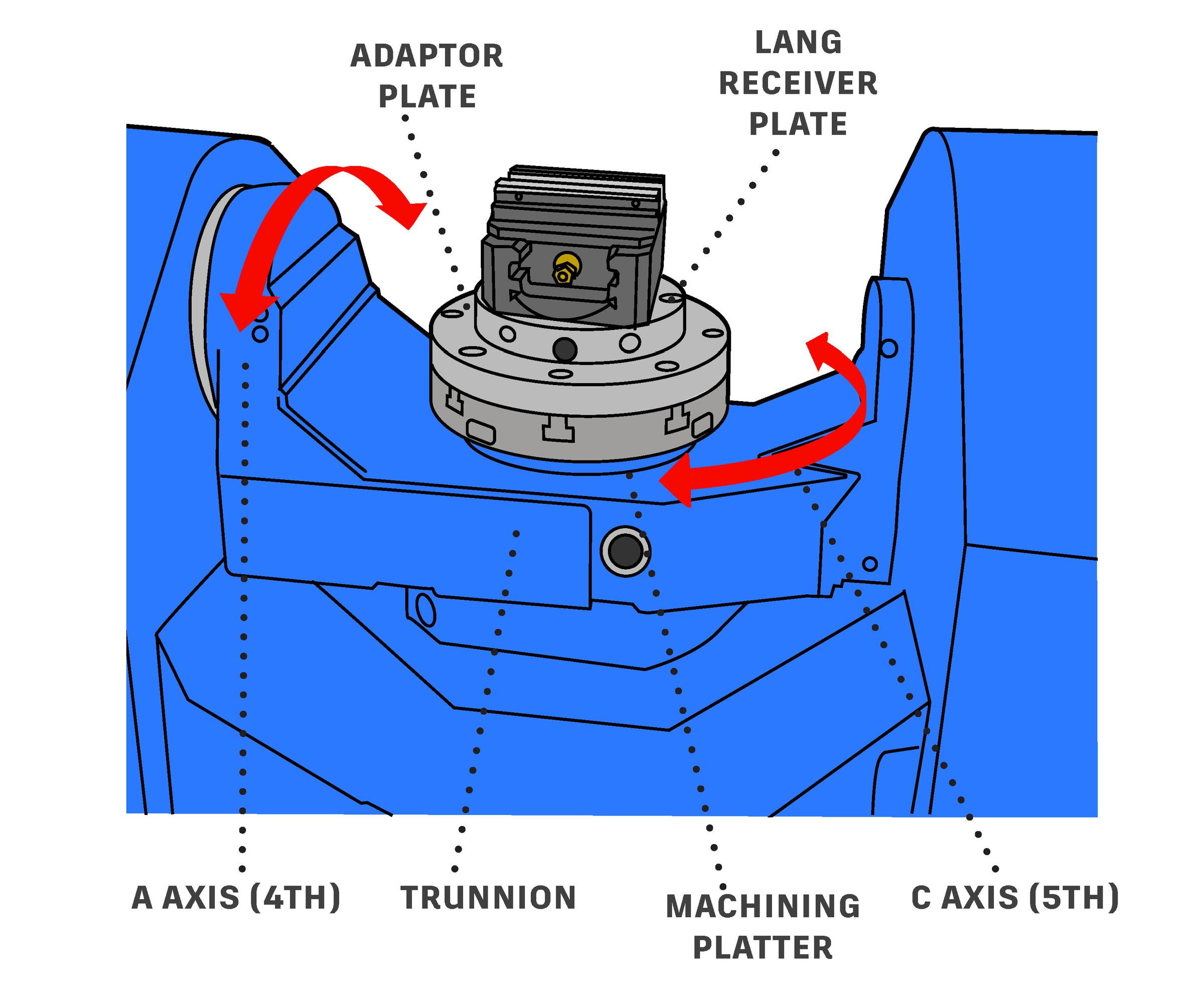

Axes
- The Matsuura has three linear axes (X, Y, and Z).
- There are two rotational axes (A and C).
- The 4th Axis, (A), rotates around the X axis.
- The 5th Axis, (C), rotates around the Z axis.
