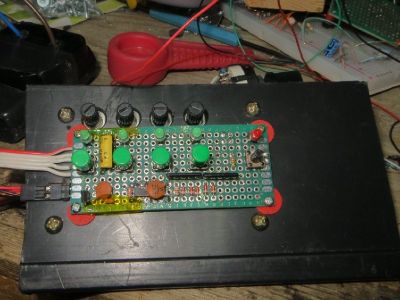

The circuit is built on perforated board and the connections are made using a home made wiring pen loaded with 0.1mm magnet wire. 0.1mm is a bit fine, but it's cheap and plentiful. The wire has a polyurethane coating which melts when you solder it. A standard iron will melt it very easily, but a temperature adjustable one will probably need to be turned up higher than you would normally use it. Beware of using "plain old enamel" wire which won't do this. It's uncommon but you might find it if you reclaim wire.
I used 2 double sided perforated boards, each with 24x10 holes, one for the preset switches and LEDs, and the other to mount the presets and the timer. The two boards are mounted on opposite sides of a piece of plastic so that the tops of the presets are nearly flush with the front panel. This way, when fitted to a panel, they can be adjusted with a screwdriver but can't be accidentally knocked out of adjustment.
The random setting potentiometer is mounted so that it can be fitted with an adjustment knob. The switch for it is off-set and has a different coloured button and LED.
The switched timing resistors R6-R10, are mounted on the pins of one half of the rotary switch. The other half of the switch has it's pins wired as a group of 2, a group of 3, and a single pin. R2, R4 and R5 are also mounted directly on the switch, connecting these sections together. This way the switch needs only 3 connecting wires.
Connect the timing capacitor directly to the switch at first because you will probably need to experiment with the value a bit and it's easier to do this way. When it's right, move the capacitor (or combination of capacitors) to the PCB.
The presets are mounted along the edge of the timing board so their mounting lugs are against it's edge. Each one has pins 2 and 3 shorted together. The mounting lugs are bent out a bit so they can be soldered together and the end 2 are bent over the edge of the board. This way the assembly is fairly firm.
Because the presets are wired as rheostats, it doesn't matter which way round you connect them. One pin of each is daisy-chained together and connected to a PCB pin. The other pin is connected to it's respective output on U3. Be careful when doing this as the outputs of the chip don't go in pin-order.
The decoupling cap for the 4060 is connected directly between it's power pins on the other side of the board.
I used a SMD version of the 4051 and had to bend the legs so that pins 2, 4, 5, 9, 11, 13 and 15 are up, I sited the "down" pins on pads of the prototype board and soldered them. Pins 6, 7 and 8 are all soldered onto one pad. I positioned it so that pin 3 is next to pin 10 of U1 so they can be easily connected. Because I used a DIP version of the 4060 I just bent the pin over to do this.
An 8 way right angle pin header is fitted at the left edge of the board, although actually only 7 pins are used (I used 8 for an earlier version of the design). Fit D9, D10, R25 and R26 between the pins and U3.
The power connectors are fitted into 3 way headers with Vcc in the middle to prevent accidental reverse connection.
The start switch is panel mounted, and connected with short wires. It shares a 3 way header with Vcc and Gnd, sharing the middle pin. If the header is accidentally connected the wrong way, no harm is done.
The relay and connector for the light box power (or some other device you decide to control with this) are mounted on the back of the board as they are too tall to fit between the timer and switch boards. The diode across the relay coil is mounted on the front of the board, within the relay's footprint.
Power for the circuit is provided by an old 5v wall-wart mounted inside the light box and wired to it's mains input.
Once assembled, print the dials for the presets and stick the sheet over the panel (cut the holes out first!). Adjust them to zero and mark the position on the end of each shaft with a dot of white paint (correction fluid works well). Cut out the dial for the random setting control and stick it on also.

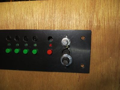

The original idea with this was that the front and back PCBs would be mounted front and back of the light box casing with a cover over the front, and I chose the presets with this in mind, however the plywood I used for the casing proved to be too thick for this, so I opted to mount the boards on a piece of ABS (previously shown) and fit this behind a large hole in the light box casing, with a cover over the front.
Hindsight being the wonderful thing it is, what I should have done is dismantle the side from the light box, drill and rebate holes for the presets, then cut out a recess for the push-button switch panel, and fasten them together using magical sparkles. Never mind...
I used two sizes of hole saw and a wood rasp to make the cut-out in the light box casing, above the power supply. The mounting panel is fitted behind the cut-out, and another piece of plastic is screwed to the outside of the case with holes for the controls. You can see I accidentally drilled a hole for a control that doesn't exist, above the selector switch for the random setting control.
The PSU is wired directly to the box's mains input and is clamped in place using shapes cut out from hardboard which are glued to the case and a small wooden batten, which is screwed in place. I fitted ferrules to the mains and PSU wires to crimp them together, which simplifies insertion into the connector block. The wires are safely tucked out of the way.
The mains input for the light box's PSU is connected to the timer's external relay connection, and an extra wire is added to connect it to the mains.
The rotary switch proved to be too far back to fit a normal knob, so I enlarged the hole in the mounting board so the switch body fits through it, so the switch it now mounted on the front panel. Really it needs to be mounted somewhere in-between. A better alternative would have been a knob which extends through the panel, but I didn't have a suitable one.
Two extra holes are drilled in the light box. One is to fit the start switch. For this I used a forstner bit to create a counter-bore before drilling the hole so that the switch can be recessed. The other is to fit the live/dummy switch which is mounted on the other side of the panel. It's drilled using two sizes of hole saw to create a hole with a rebate. I used a 3 way slide switch with centre off which I bought some by mistake years ago. It's mounted on a small piece of ABS which is fitted into the rebated hole.
The dials are created in Inkscape, printed, laminated, cut out and stuck on. (Edit: they will be when I get round to it...)
I realised that the light box now has no indication that it's connected to mains power if the timer isn't timing, so added a neon pilot light.
