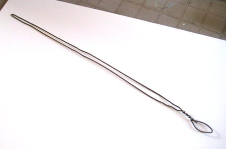

Step 1: Bend a Coat Hanger Into Shape
You are going to be casting your sword in hot melt glue with a foil skin. But so that it will be springy like a real blade, it needs a stiff core. I used a bent wire coat hanger for my core, and that seemed to work fine. If you have other similar wire then you could use that instead, but make sure that there are no sharp ends near the tip of the blade, because they might poke through the plastic outer skin and hurt someone by accident.
Pull down the bottom bar of the coat hanger and push the sides in. Straighten out the hanger as much as possible, taking care to make sure that it is not twisted or bent. This is not as easy as it sounds, because the coat hanger wire is quite springy. We need this property for later to make the blade have a spring to it, but at this stage it makes it hard to work with.
Bend the coat hanger hook round so that it is a narrow loop but centred and in a straight line with the rest of the hanger. This will\mean bending it back slightly so that the centre of the loop is centred on the axis of the straightened out hanger.

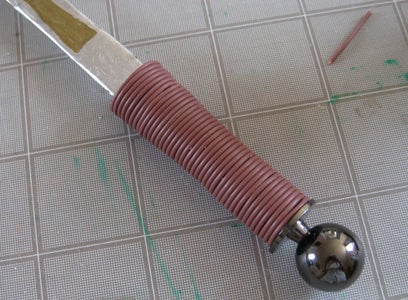

Step 7: Now Make the Handle
The handle is easy, get a short piece of garden hose pipe (yes no one will miss a bit 4 inches long!), glue gun glue inside it and push the looped end of the coat hanger into it. Wait for it to set and holding it blade tip pointing up, fill up the remainder of the pipe end with glue. When that has set, turn it up the other way. Now get that cupboard door knob, screw in the fixing screw and glue that into the other end of the hose pipe.
now the little bit of hose pipe should be filled with hot melt and have the blade stuck firmly in one end and the cupboard door know in the other.
Step 8: Bind the Handle
Bare off about 3 meters (3 yards) some electrical cable. The way to do this is to make a longitudinal slit through the wire near its end, pull the bare earth wire free and holding it with a pair of pliers pull it along the length of the cable to split the cable.
use one of the wires inside to wrap round the sword handle to make it sturdy. glue one end and start winding, remembering to keep it tight. Glue a dab of hot melt every so often, to make sure that it stays in place.
When you've wound it all along the handle glue it off, then making sure to mask the pommel and the blade at either end, spray the wire handle black.
When the black paint dries, burnish gold or silver on to the top edges to give some distressing, a bit of age and some lovely extra detail.
