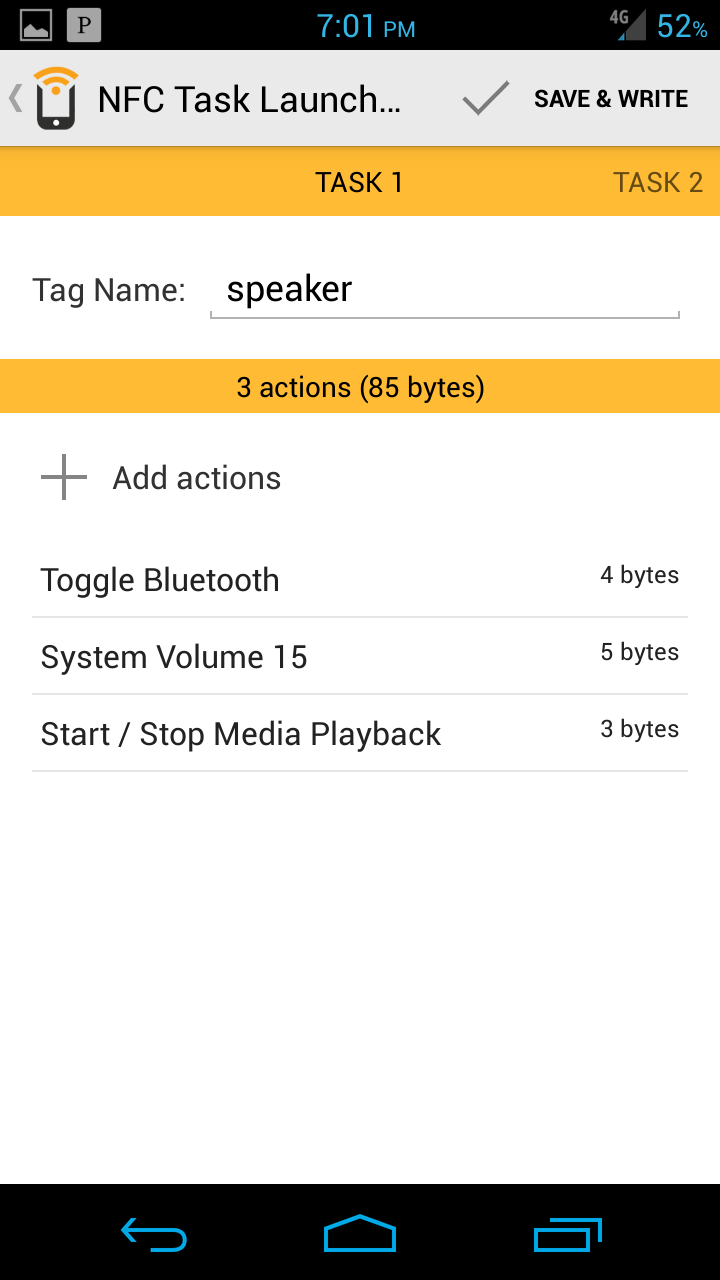

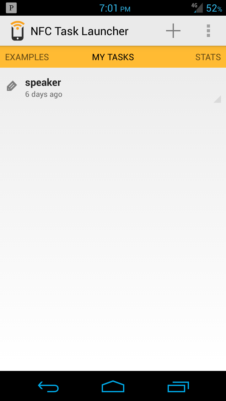

Finally, the added bonus of an NFC chip to directly connect to the Bluetooth was added on the vacant top side. For those unfamiliar, NFC or Near Field Communication is now being embedded in modern smartphones (excluding apple products) to allow for a quick tap and activate solution. The NFC chip takes short wave transmission and powers itself just long enough for the phone to read the tag. Users can write certain code to tags in order to do different actions.
I have been meaning to put my phone's NFC ability to use and I thought that it was time I did so via this project. After you purchase the tags which can come from many different supplies, download an app called NFC Task Launcher. Click the add button to set up a new NFC task. You can give it a name and set a handful of task to start when the tag is touched. For example, I chose to start my Bluetooth connection, max out the volume, and open a music app. Once you are done, tap save and write while you have your phone over the tag. The information will be stored and now each time you tap the tag on the speaker, you will instantly be connected without going through sub-menus to setup your connection.
