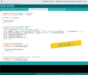

Step 3: Printing "Hello From ESP8266 NodeMCU ..."
Typing in your web browser (ESP8266 IP address)/TestPrint1 will show you a print button to execute the test.
After pressed the button a printer dialog will ask you to select a cloud printer.
In the "HandleFileRead()" function in the "ESP8266_Utils_Server.hpp" file you can find the code to print the message as you can see in the PICTURE 1.
In the PICTURE 2 you can see the web page for the TestPrint1 and the Google Cloud Print dialog to select a cloud printer once you have pushed the default printer button.
