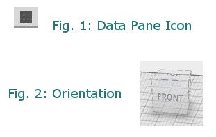

Now let's get used to adjusting your 3D view. First notice the top right corner of the screen. You should see a cube representing your workspace and the angle you're viewing from (fig. 2) This will allow you to navigate easily to a particular orientation, to ensure that your view is perfectly aligned. Try working your way around the cube, clicking each side and pay attention to how your view changes.

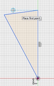

This is why we're here, on the quest for our perfect guitar pick. Here you have the opportunity to either try to replicate your usual pick, or do something different. For this, all we really need is a triangle to start. What we are trying to do is sketch one side of the pick, as if you cut it right down the middle. You can make the dimensions whatever you like, but I recommend at MINIMUM 30mm long and 13-14mm wide.
To do this, you should start your first point on the origin where the axes meet by clicking there, and then drag your mouse upwards along the y axis. You will notice that it tells you the length of your line, and this is what you want to be 30mm. It's very important to ensure that your first line stays straight along the axes, and as you should have grip snapping on by default that shouldn't be a problem. Once you hit your desired height you can click and move on to the next point. Again you will have a measurement for reference, this is where you will have between 13-14mm. You can use whatever angle you like here, it really doesn't matter since it will all be adjustable after. It certainly doesn't hurt to start where you think you'd like After you've set your second point simply go back to your first point and click to close your sketch. If at any point you don't like what's going on, just hit ctrl+Z to undo whatever you just did and try again.

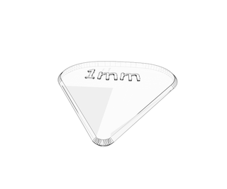

If you plan on printing multiple different sizes of pick, you might want to label them. For one thing this will allow you to tell them apart at a glance, and for another it will add some grip. You can also simply use what you've learned to sketch a design, or maybe features like a thick ridge near the back, or whatever you like. For our purposes though, we'll be using text.
First of course you'll select the text tool from the sketch menu, and then you'll select roughly where you want the text to be. It may ask you again which plane you would like to sketch on and you will again be selecting the xy plane. Keep in mind, once the text is sketched it will be sitting flat on that plane, below the pick. In the image you will see that I have written '1mm', with a height of 5mm to fit properly on the pick. I have also used Comic Sans simply to annoy people. Because it is under the pick, you may find that you have to orbit the camera to the underside in order to select it. You can also click the little light bulb next to 'Bodies' on the left side of the screen, which will toggle visibility of your pick or any other extruded body you may have in the future. Just remember to turn it back on!
In my example I have made the extrusion 1.2mm, and set it to Join. This gives me writing on the pick that will be .2mm thick. If you change the 'Operation' to cut instead you'll actually cut the writing out of the pick entirely, which can be a problem with letters like O or B. Also try to be realistic with your designs. Remember that we're talking about fractions of a millimeter here and not every printer will be able to produce very fine details. Once again, we could call it complete, but maybe you don't want the hard edges around your pick. That's fine, we have options in the next step.

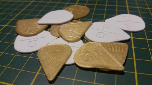

By now, you should basically be looking at exactly the guitar pick you've been dreaming of for your entire life. You're welcome, but it gets better. Pretty soon you'll be holding it in your hand. If you want to do anything else to it now's the time. Next, we're ready to create the file that we will print our pick from.
Step 11: Export Your Design and Print
Before you can print your pick you're going to have to create an STL file. This turns our object into what's called a mesh. You can see in the composite image I've made that this mesh will be highlighted in blue. All you have to do is hit the Make button, then select your object and hit OK. This will bring up a prompt where you can name your file and decide where to save it. After that, it's done, you're ready to go! This is the file you will upload to a service, or bring to your library. If you are using your own printer, and you're already familiar with slicing objects you can choose to send it to your slicer by checking the box to send to 3D print utility.
So that's about it, by now if you've done your homework you should be uploading your file to shapeways, emailing/bringing it to your library, or printing it yourself. Maybe you even did a few more designs, to try different shapes and thicknesses. You can easily print many different sizes and shapes at the same time if you like so go ahead and try out a few if you haven't already. This is the hardest part of the whole process...waiting!
