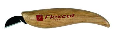

Hello again! Welcome to my instructable for a wood carving knife. The concept of one of these knives is that while using it you have more control over the small blade via the handle that is bigger than the blade. This is a dandy little knife, and is good for many wood carvings. Although, these knives are very sharp, so be careful. Once I was at scout camp and I brought one of these for the carving merit badge and my friend asked if he could use it and I agreed. a half hour later, he went to the clinic for stitches because he had slipped. So please, be careful with this!

Step 2: The Handle
For this you will need to cut your wood to 1' x 6'. The total length is 5", but you may as well give yourself some leeway. Then you need to cut it out to this shape. I tried to draw out the measurements but it wouldn't save, so here they are. 5" in length, 1 4/8" at the thickest and 3/4" at the thinnest. I cut out on a band saw, but you can use anything else you have. TIP: if you cut it a little wider then you mark it, you have room to sand down the rough spots. Then you have to sand it down smooth and round the edges off. After this, the handle is done except for one thing that needs to be done later.

Step 4: Joining the Blade to the Handle
Now to join these parts together. First, drill a hole with a 3/8 drill bit in the center of the front face. Now take the epoxy and mix about half dollar sized puddle and pour a little into the hole. Then, stick the blade into the hole and squeeze the rest of the epoxy into the hole until it is full. If you need to, hold the blade straight until the epoxy is dry enough to let go. After it is completely dry, it is time for the next step.
