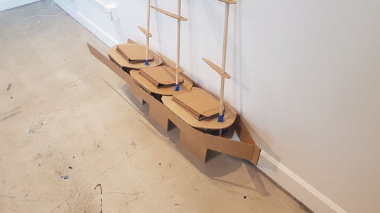

I tested some of my assumptions on Protei Cardboard Model (instructable), So I had a rough idea of where I was going. I wanted something simple with a
  1. single hinge mechanism
  2. module size based on internal minimal components (batteries, receiver, 2 servomotors)
  3. Flexible scale design to avoid gaps on the sides
  4. Easy to laser cut and assemble with cheap materials

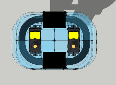

Step 5: How to Power This Modular Boat? Servo Motors
I am using the container "Rubbermaid Brilliance Small size". I couldnt find it online, so I modeled it here:
For the servomotor. I found it on on 3D warehouse, thanks luismi911:
Next, I proceeded to check if the servos would fit, and yes, 2 of them would be comfortable in this small box, sticking out.
I will use 2 standard servos for this.
  • Servo A would control the sail / wing
  • Servo B would connect to the next module, and "bend" the boat

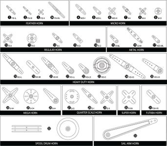

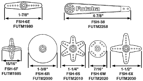

Step 11: How to Make Custom Horns for My Servo Motors?
Futaba provides a page with the dimensions of their Servo Motors horns:
http://www.futabarc.com/parts/futm1980.html
I assumed I was going to use this one I found on 3dWarehouse:
https://3dwarehouse.sketchup.com/model.html?id=986...
I had to scale it to the size referenced by Futaba.
I did not buy the official Futaba brand, but another standard size servo that works just fine.

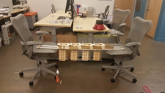

Step 16: Assembly of All the Modules
I transformed my office table into a sort of mini production line. Here in the picture holding Protei Mini-RC "Sputnik" is Gabriella Levine - dear friend.
