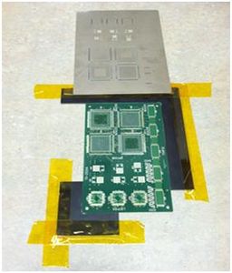

Inspect the PCB to make sure you are starting with the right design. If there are a lot of finger marks on the PCB wipe the surface down with a lint free cloth using isopropyl alcohol. Make sure the stencil is correct and lines up with the PCB pads which need to be printed. Affix the board holder in place using tape (either a 2” wide Kapton or blue painters tape).
Step 2: Place the Board
Place the board in the upper corner of the holder.
Step 3: Place the Other Board Holder in the Opposite Corner
Place the other board holder in the opposite corner to the board. Use tape to affix the hold in position when it lines up. Allow for some room to place the boards in and out of the holders.
Step 4: Align the Metal Foil Stencil
Align the metal foil stencil over the board aligning the apertures to the pads of the board. Affix the foil with tape so it will not move during the squeegeeing process. Sometime I only affix the stencil at one edge so it can be a flap and move up/down to “unload” and “reload” boards in to the fixture.
