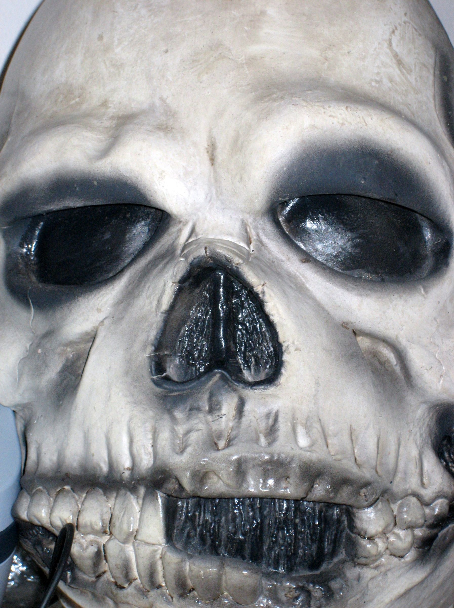

I picked a rubber mask and cut a piece of foam rubber to fit, not to tight but big enough to hold it's form. The foam rubber was from an old mattress.
Using a straight piece of metal coat hanger I heated it with a torch and melted (hollowed out) a space to fit a piece of 1/2 pipe with a T fitting that had small pieces of pipe already glued in. This allows for mounting the head to the structure. I glued the upright piece in the T once I had the T in the head.
Also I hollowed a space to snake a piece of hose so the outlet was at his mouth. I used some black automotive hose I had laying around. On the end I put a hose clamp then bent it closed a little to widen and thin out the water stream.
