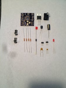

Before starting check your kit to make sure you have all the parts.
Your parts list (if you bought this from Purple Squirrel) should include these 16 pieces:
(1) PCB
(1) LM317 Voltage Regulator
(2) SPDT Slide Switches
(2) 0.1” Header Pins
(1) 100uF 25V Aluminum Electrolytic Capacitor
(1) 10uF 25V Electrolytic Capacitor
(1) 0.1uF 50V Ceramic Capacitor
(1) PTC resettable fuse
(1) LED, Red
(1) 390 ohm resistor
(2) 330 ohm resistors
(1) 240 ohm resistor
(1) 1N5818 Reverse Protection Diode

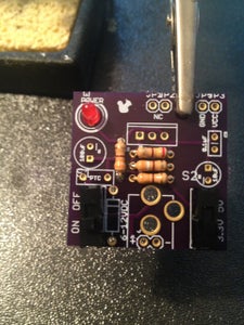

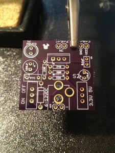

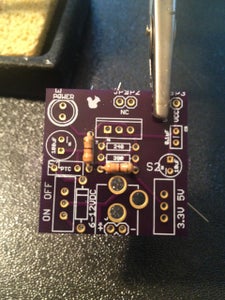

Start with the PCB

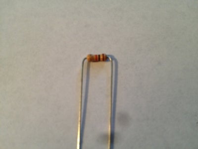

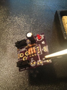

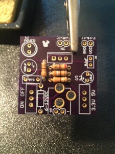

Step 3: Installing the Resistors

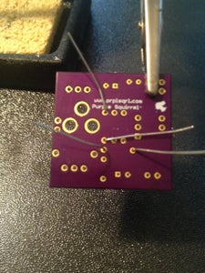

First we are going to attach the 330 ohm resistors.
You may need to pre bend the leads like the picture to get the parts to fit.

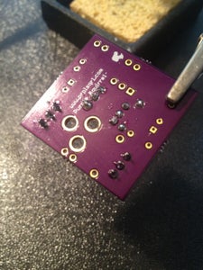

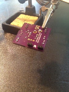

Once the resistor is in the location turn the PCB over and bend the leads a bit as shown…this will hold the part in place while you solder it down.
After soldering the leads down, trim them off so they look something like the picture.
Repeat the above steps for the remaining resistors (390 ohm and the 240 ohm).

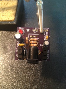

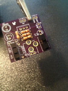

Step 4: Installing the SPDT Slide Switches
When installing these remember the leads on these parts do not easily bend. Also orientation is not critical as you can put these in and they will work regardless of which way you install them.
Because the leads don’t bend I put them in to their positions first and then turned the whole assembly over and let the PCB rest on the switches and then soldered the leads down.

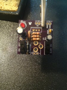

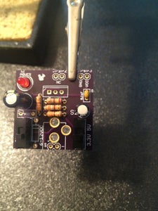

Step 5: Installing the LED
The LED, a diode that gives off light, conforms to a polarity scheme. The longest lead is positive (the Anode) and the shorter lead is negative (the Cathode). The PCB shows a flat edge on the silkscreen marking for the LED. This flat side indicates the side that the negative lead or the Cathode should be installed in.

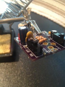

Step 6: Installing the Capacitors
Install the 100uF capacitor first. It’s the largest one of the capacitors and is marked on its side with “25V 100uF” This part is polarized. There is a marking on the side of the capacitor that indicates the negative polarity AND the negative lead is shorter. On the PCB there is a mark on the silkscreen to indicate the negative pin.
Install the 10uF capacitor as you did the 100uF one. The 10uF capacitor has the markings “25V 10uF” on the side. You will also see the same marking indicating the negative side of the capacitor along with the negative lead being shorter.

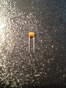

The 0.1uF capacitor is the smallest capacitor of the three as well as the smallest part in the kit. This type of capacitor is not polarized as it is a ceramic type of device and as such can be installed without any concerns regarding polarity as shown in the pictures.

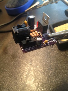

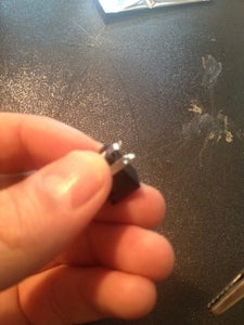

Step 9: The DC Connector Jack

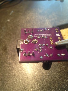

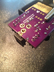

Installing the DC connector jack is rather easy. The leads are such that the connector jack will clip into the PCB and hold itself into place. Once its clipped into the PCB turn the board over and apply solder…NOTE you might need to apply a bit more solder than you think to solder this part down. Don’t worry you can add solder to both sides of the footprint to get a good connection.

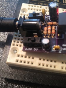

Step 10: Installing the 0.1” Spaced Headers
I waited till near the end to put these in because they are installed from under the PCB (see pictures) to allow you to install this power supply into a bread board.
I installed these into the PCB from underneath and let the PCB rest on the headers. This allowed me to solder the pins from the top side of the PCB.

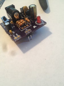

Step 11: Installing the LM317 Voltage Regulator

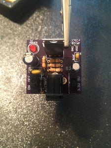

I waited till last for this part because of its size. The benefit here is that because it size and the length of the leads you can put this part into the PCB and turn the entire PCB over and let it rest on the voltage regulator so you can solder the leads down. Once soldered in trim the excess.

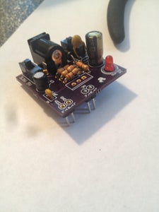

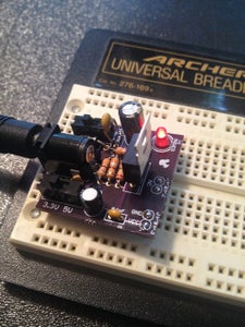

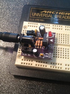

When it is all said and done your power supply kit should look like this when you are finished.

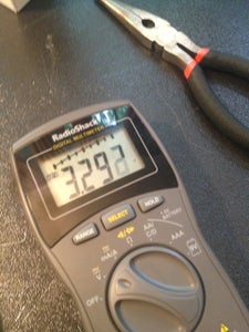

Step 12: Lets Test the Kit :-)

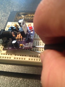

To test the kit we plug a wall wart power supply into the DC connector…you will notice I didn’t plug the unit into bread board because I wanted to have an easy way to measure the output voltage with one hand and take a picture with another.
Once its plugged we switch the ON/OFF switch to ON and you should see the LED light up. I set the voltage selection to 3.3V.
Put the probes on the Vout pins and we see….3.29V.

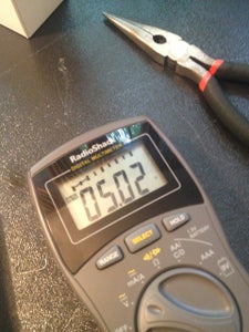

Now we switch the voltage selection switch to 5V.
Put the probes on the Vout pins and we see…5.02V
There you have it, a fully functional power supply that will give you 3.3V and 5V and up to 500mA of current.
