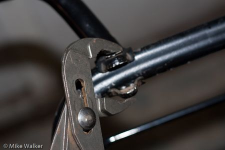

and with some finagling with a pair of alligator pliers and some taps with a dead blow, I go them to slide on. Taking the BIG pliers I readjusted the bar end jaws, by squeezing really HARD!
