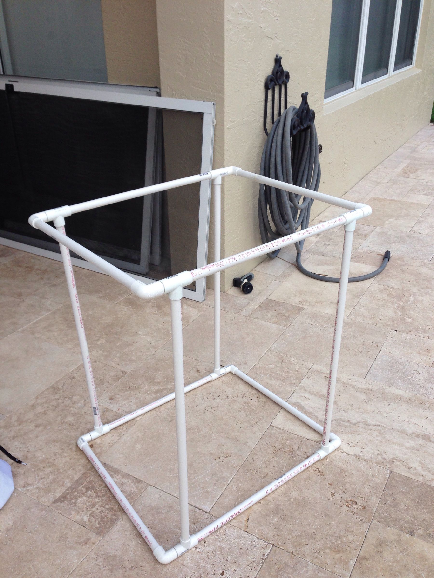

Introduction: Pvc Pipe RC Air Plane Holder
This Project uses pvc piping the kind used in plumbing at homes to make a place to hold Rc airplanes. This holder holds aircore and most small slow fliers. This can be used for other things also if you come up with something please comment about your idea.

Cut 8, 4 inch pieces of pvc
Cut 2, 3 1/2 inch pieces of pvc
Cut 6, 18 inch pieces of pvc
Step 4: Putting It All Together
Take the 3 1/2 inch piece and put 2 90' turn pieces on both ends do this again to the other 3 1/2 inch piece. Put the 4 inch pieces in each of the 90' pieces connect the pvc to the 3 way piece do this 2 more times on each side then connect it to the remaining 90' and 3 1/2 in piece. Put an 18 inch piece of pvc in the remaining part of the three way on all the three ways so it looks like the pictures.
