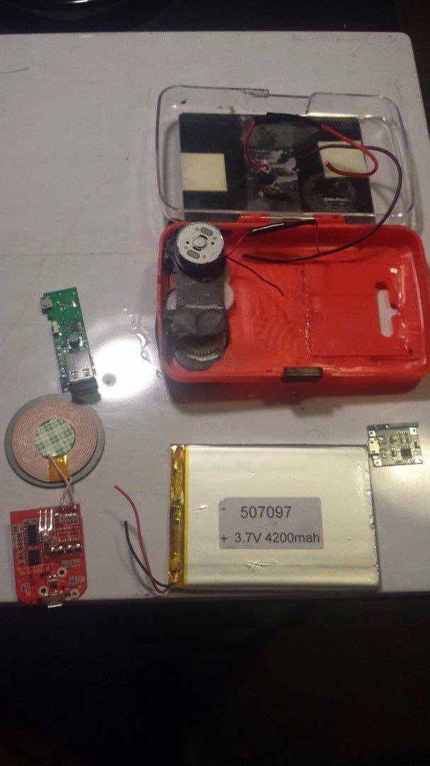

For this project you'll need a bunch of electronic parts, a case that will fit them all, and some adhesives or putties that will allow you to fix them all into the case and provide some structure and reinforcement. You'll also need some cutting tools and a soldering iron with solder for the electrical connections. If you don't have experience soldering, don't worry! There aren't any complex solders if you get the right parts, and you can even get away with twisting wires and securing them with heat shrink or electrical tape. There are myriad videos on Youtube to teach you how to solder as well.
Here's a list of the parts I used:

Parts:

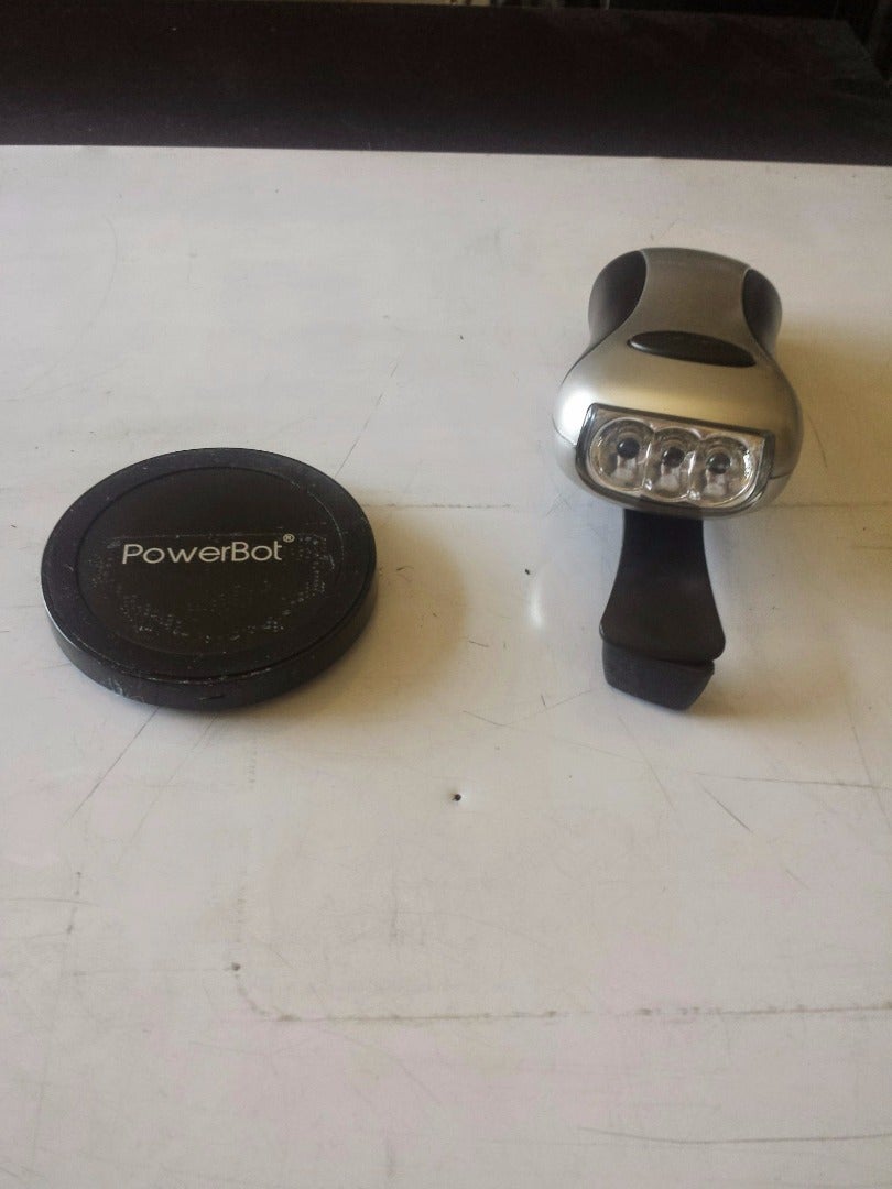

1. Solar panel (I decided on one because of its size. It fit right on top of the case without and extending edges. Realize that solar charging time is dependent on the panel size. I have a small panel wi)
2. Hand Crank Dynamo (I pulled my from a hand-crank flashlight. Just break open the case and pull out the dynamo. Be sure to keep track of the gear placement.
3. Project Case (I picked the case of a little screwdriver set I had that seemed big enough for all the parts and wasn't much bigger than my cell phone).
4. Charge Controller (TP4056, more on this later)
5. DC-DC converter (I chose one with 2 USB outputs. You can choose one USB output and split it, or just go with one output if you don't want to use a wireless charger)
6. Wire (16 gauge or higher. Any thicker and you'll be dealing with internal resistance and losing power)
7. Lithium Polymer Battery (As large as you'd like. I went with a 4200 mAH battery, which will charge my phone 3 times over without needing its own recharge) Be sure it uses PCB protection. Most phone batteries have this, but just be sure it's there if you're buying one from eBay like I did.
8. 2 Diodes (I used a 1N4001 Diode, but it's rated way higher than I needed it to be. So check the diode's spec sheet and just be sure it can accommodate the outputs from the solar panel and the hand crank).

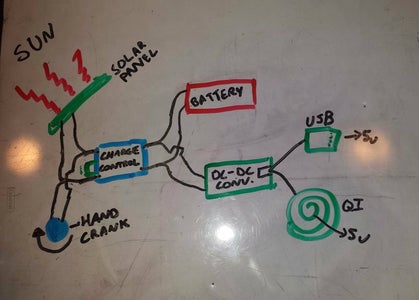

Step 2: Create a Plan of Attack While You Wait for Parts to Arrive

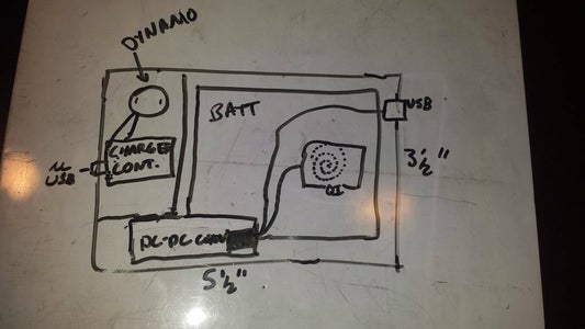

I have a background in engineering, so naturally I had to plan everything on a whiteboard with specs and quasi-circuit diagrams and dimensions. It really helps to know whats going to happen with this project before you make the first cut or do anything irreversible. I knew where each part would go and how every connection would be done before the first circuit board arrived because of proper planning.

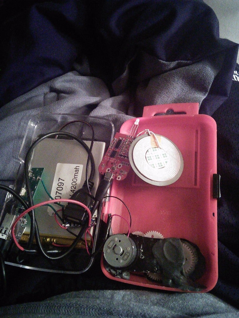

Step 3: Place All the Parts and Cut Some Holes

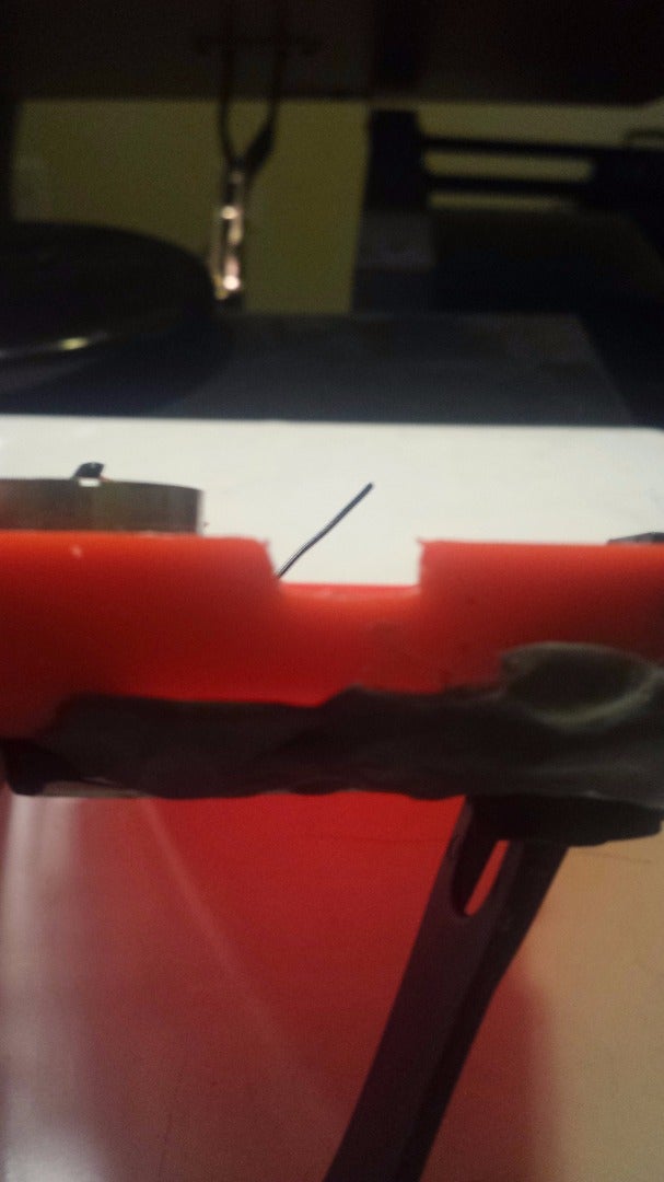

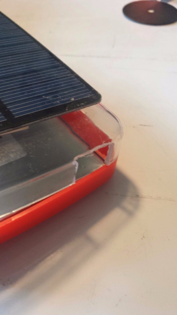

The solar panel and hand crank will live on the outside of the case, so you'll need to start with those.

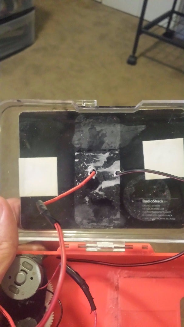

Drill 2 small holes for the solar panel wires to go through. Then secure the panel with Sugru. Sugru works so well for this part because it will create a solid protective ridge around the panel, as well as provide an anti-skid surface for wireless charging on the other side. Make a ridge that is higher than the panel, so that you can prevent scratching of the panel if it lays on that side. Allow the Sugru to cure for the specified time on the packaging (24 Hours, I believe). In the meantime, you can cut a hole in the bottom of your case to hold the dynamo. You want the dynamo inside the case, and the hand crank outside, so cut just enough of the case to allow the gears and motor inside. Secure the dynamo with epoxy putty. This stuff cures quickly so be sure you have everything in place and there is no putty in the gears. It helps to spin the crank while its curing just to ensure the movement isn't impeded.
Next, place (don't secure yet) the circuit boards and cables where you planned to. Ensure a good fit and make sure your case can close still. From there, measure the lengths of wire you'll need to make all the connections. You'll need 2 coming from the DC-DC converter, as well as any wires you may need to extend the battery, solar panel, or dynamo motor to the charge controller.
Once everything is in place, mark and cut your ports with a Dremel or maybe a utility knife if your case is plastic.. You'll need a port for the micro-USB port on the charge controller, one for the female USB plug, and an optional port for the switch if you're using a wireless charger.

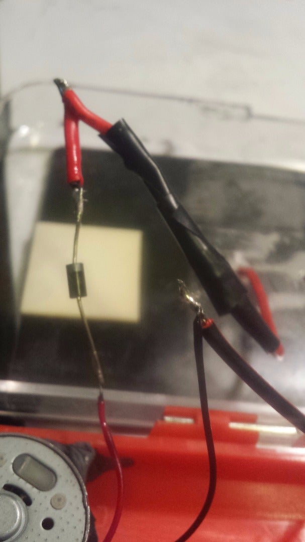

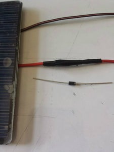

Step 4: Understanding Your Parts/Set Up the Diodes
Charge controller: These do exactly what you think they would do: control charging. They are made to take an electrical input (solar, crank, and micro USB) and regulate it to make it usable for charging your battery, which puts out 3.7 volts. It adds protection against overcharging and overheating, and adds a point of failure to prevent a catastrophic battery failure. This controller I chose (TP4056) acts as the gateway between input and output, and has a convenient LED to show when charging (Red) and when the battery is charged (Blue). It also allows for micro-USB charging, so when you have access to a wall outlet you can just plug in a standard phone charger to give your battery a full charge. The hand crank and solar panel take a while to charge the battery, so this is a really nice feature. Everything that supplies power (solar panel and hand crank) will go on the INPUT side of the charge controller, and everything that uses power (battery, DC-DC Converter) will go on the OUTPUT side of the charge controller. Solder a diode onto the positive wire of the solar panel. A diode works as a one-way valve for current. You want current going away from the panel and not towards it, so put the "bar" of the diode away from the panel. Same concept for the dynamo, solder the diode on the positive wire of the motor with the bar facing away (or towards the charge controller)

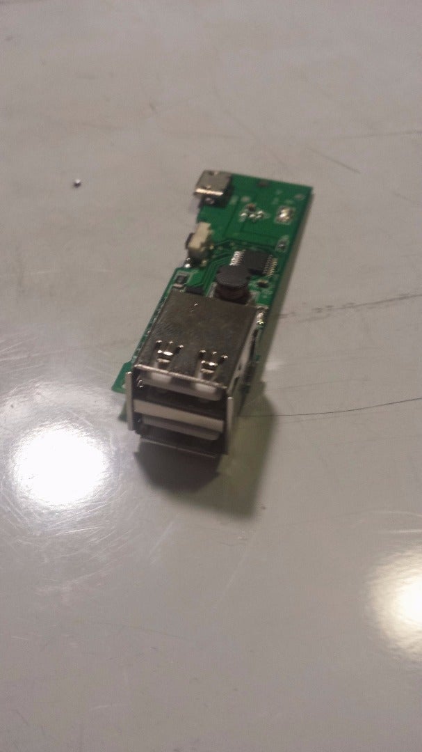

DC-DC Converter: This device allows the Voltage from the battery to be stepped up from 3.7 V to 5 V to make it usable to the USB ports, which require 5 V. I chose one with 2 USB ports; one for a USB extension cable to reach the port I had cut, and another to connect to a micro USB cable to the wireless charger.
Solar Panel: Solar panels are photovoltaic cells that convert sunlight to electricity. However, they are inefficient, and put out only a couple hundred milliamps at best. Remember, Power=Voltage*Current. More power at a given voltage (must be 5V at least) means higher current, but also means increased size and cost of the panel. My panel is small and therefore weak, only putting out about 167 mA at 6 Volts. (6*0.167=1 W). At 167 mA, it would take 25 hours of direct sunlight for my battery to get a full charge, which is why I added the option of a hand crank dynamo.

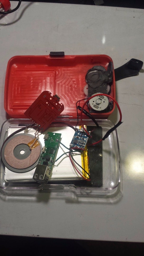

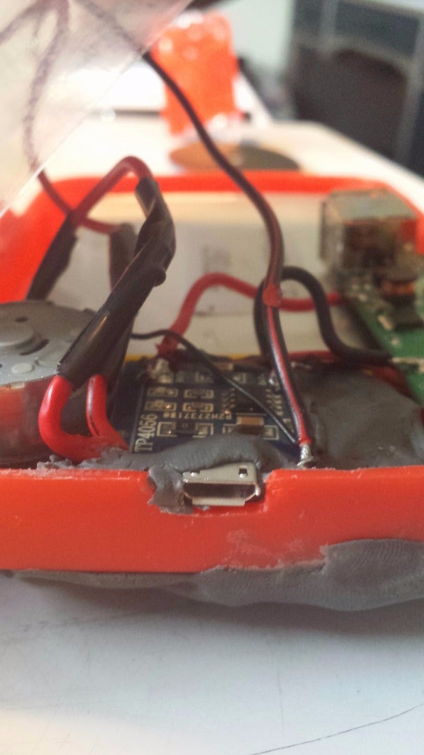

Step 5: Solder Everything Together and Test
Now that you have your case prepared and you know where everything's going, you can create your electrical connections.

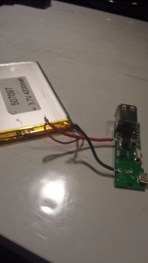

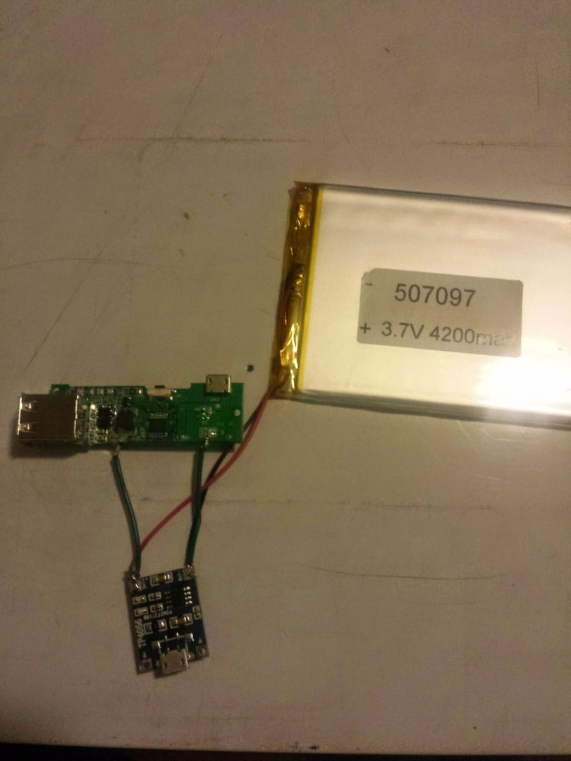

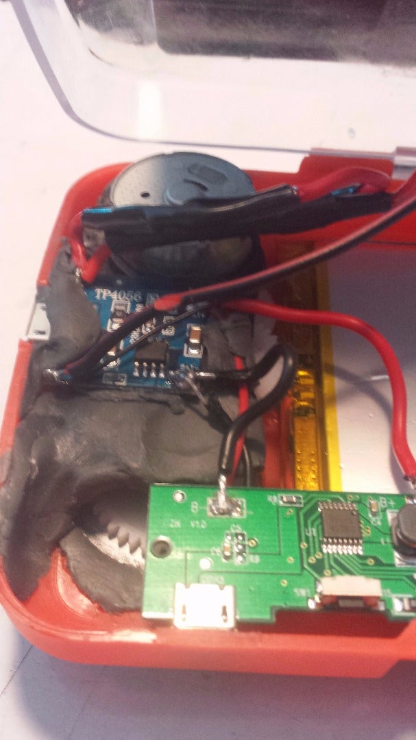

You have a positive and negative input terminal on the charge controller, and a positive and negative "battery" terminal. Your power comes from 2 sources (3 counting the micro-USB), so you'll have to splice together the positive and negative wires from the solar panel and the dynamo. Just tin and solder the wires together, then solder that connection to the appropriate terminal on the charge controller. Orient the wires to that their placement won't interfere with the charge controller's position or block the micro-USB plug's port on the case.
Now you'll want to solder wires onto the DC-DC converter. Make sure they're an appropriate length to reach the charge controller. Next, you'll do the same thing as before with the battery and charge controller wires. Solder the positive wires together, then solder that connection to the positive terminal on the output side of the charge controller. Do the same with the negative side.
Boom! That's it, all the connections have been made.

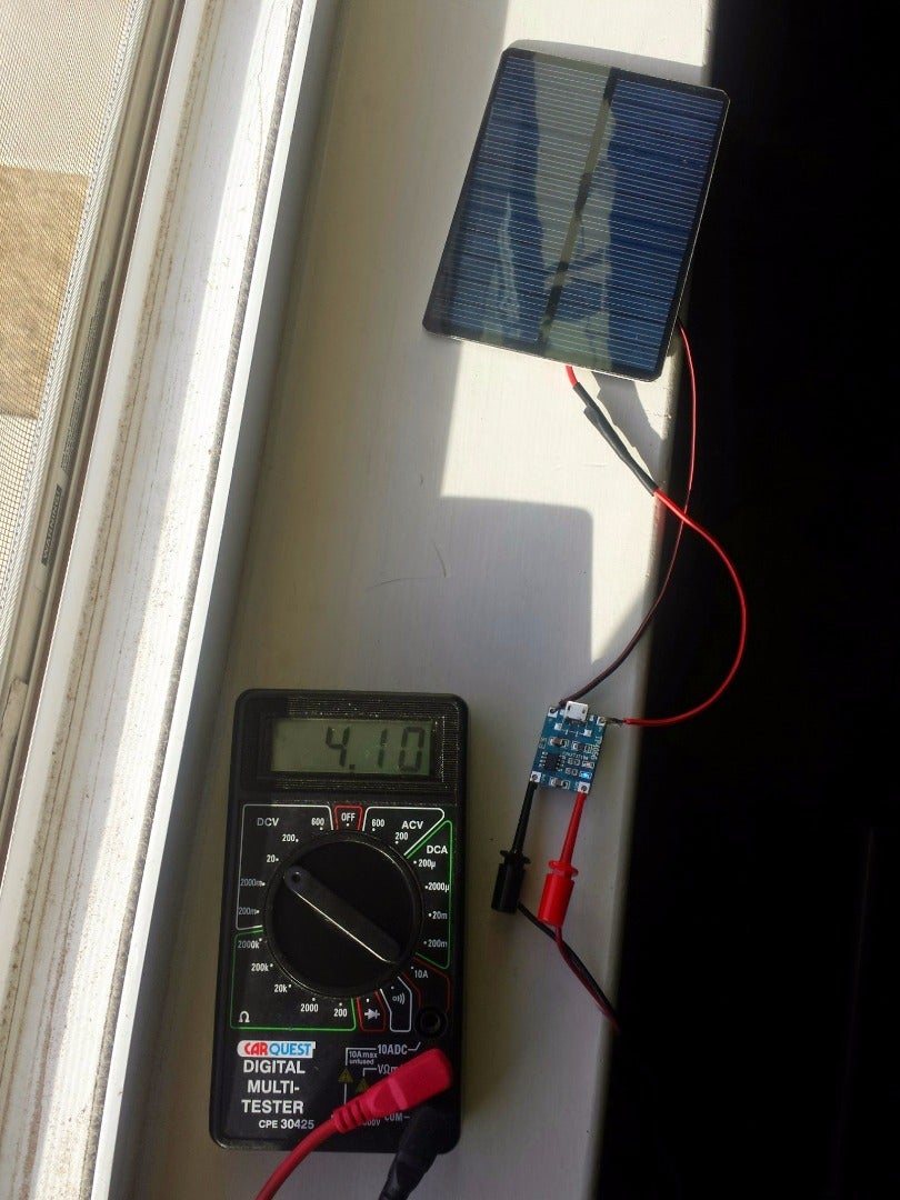

Now you'll want to test these connections and adjust them as necessary. Check that the hand crank works: spin it and look for the charging light. Put the panel in the sun and look for the light. Then plug a micro-USB cable into the plug on the charge controller and look for the light. Once your battery is charged, check that the DC-DC converter works by either plugging in a USB cable and charging your phone, or checking the plug with a multimeter for 5V.

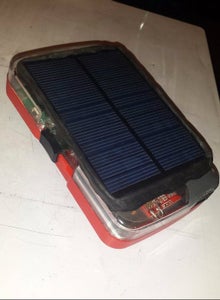

Step 6: Secure the Parts
Now that everything is connected and works, you can secure everything to the case. I decided to go with epoxy putty. It's strong, non-conductive, and sets within 5 minutes. Knead the putty so it mixes well and place little pea sized shapes on the bottom of the charge controller and DC-DC converter and just stick them to the case where you planned to earlier. I chose to secure the wireless charging coil to the bottom of the battery so it faces the bottom of the case, then i secured the wireless charger's board on the top of the battery. I placed the charge controller on top of the hand crank with the micro-USB plug sitting in a little channel i cut into the case. I placed the DC-DC converter on top of the battery as well. Just make sure everything is secure and not obstructing anything else before the epoxy putty sets. You may want to give the hand crank a spin to make sure nothing is blocking the gears. I secured the USB output on the opposite side of the micro-USB.
You're almost done!
You're almost done!

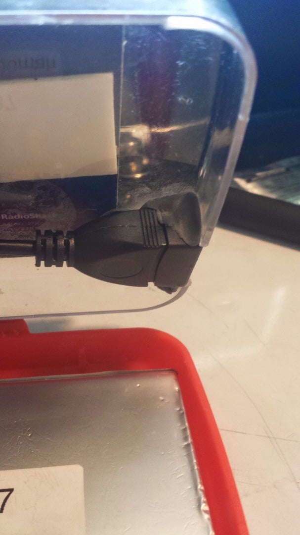

Step 7: Finish Up and Take It Out for a Spin

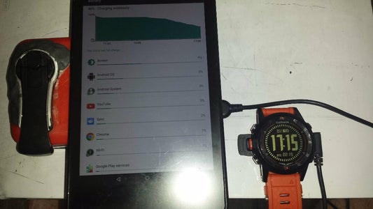

Now all you have left to do is plug in the cables to the DC-DC converter. I plugged in the micro-USB cable for the wireless charger into the high-amp output of the converter to allow for better inductive charging, and the USB extension cable into the low amp output.
Organize the cables, make sure nothing is pulling on the wires, and close up the case! Secure it however you'd like. My case has a latch that I use to easily open it up and unplug the wireless charger when it's not in use. But again, you can opt to add a switch to the converter to control this without opening the case.
Bonus note: You can unhook the hand crank and use it as a prop for solar charging to get it into direct sunlight. Just turn the crank to position the panel in the best angle to get the most sun.

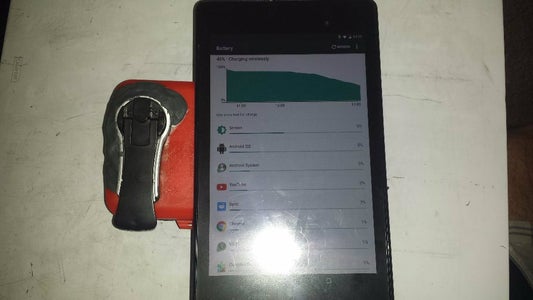

Charge up the battery however you'd like: plug it into a wall, put it in the sun, or crank until you see a blue light.

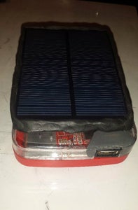

You now have a large capacity power bank with multiple charging options and Qi capability! Great Job. Looking back at my constraints, I was able to meet every one of them. This is the ultimate tool to power your gadgets out in the wild. I hope you enjoyed this Instructable, and if you make it yourself or have any comments/critiques on this build please share them with me!
