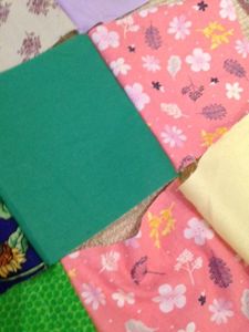

Step 1: Quilting Squares
1: Depending on your availability, cut or buy 92 5x5 in squares of cloth (I cut them because I have a ton of fabric I wanted to unload)

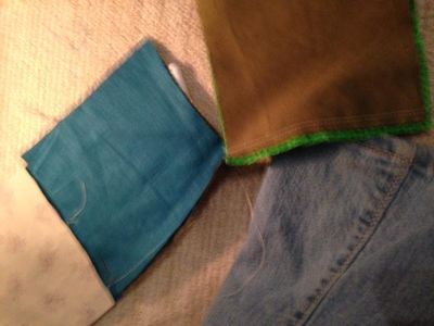

Step 6: Cut Seams
6: Once you have finished stitching long ways, cut the seams between each square.

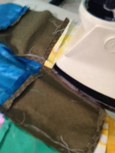

Step 7: Iron Seams
7: Iron the seams facing open.
Step 8: Sew Rows Together
8: Pin and sew the rows of squares together.
Step 9: Iron Rows
9: Iron seams facing out.

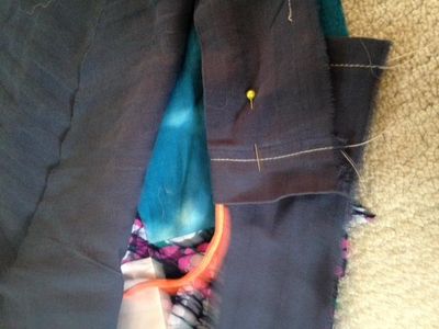

Step 18: Pin Project
18: Align your circles with right sides facing together. Insert the strips on both sides with the seam your did in step 15 facing out. Where the strip ends, place the smaller strip of fabric inside the area you didn't sew and between the two circles. (See photo) Pin everything together.
Step 19: Stitch Assembly of Project
19: Stitch everything together! Leave a 3 inch opening. Since it was such a big thing, I stitched about 1/4 of the way, reinforced my stitch and checked to make sure everything looked good by flipping it right sides out.

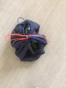

Step 23: Finishing-Tie and Test
23: Tie paracord ends together and test your project!
