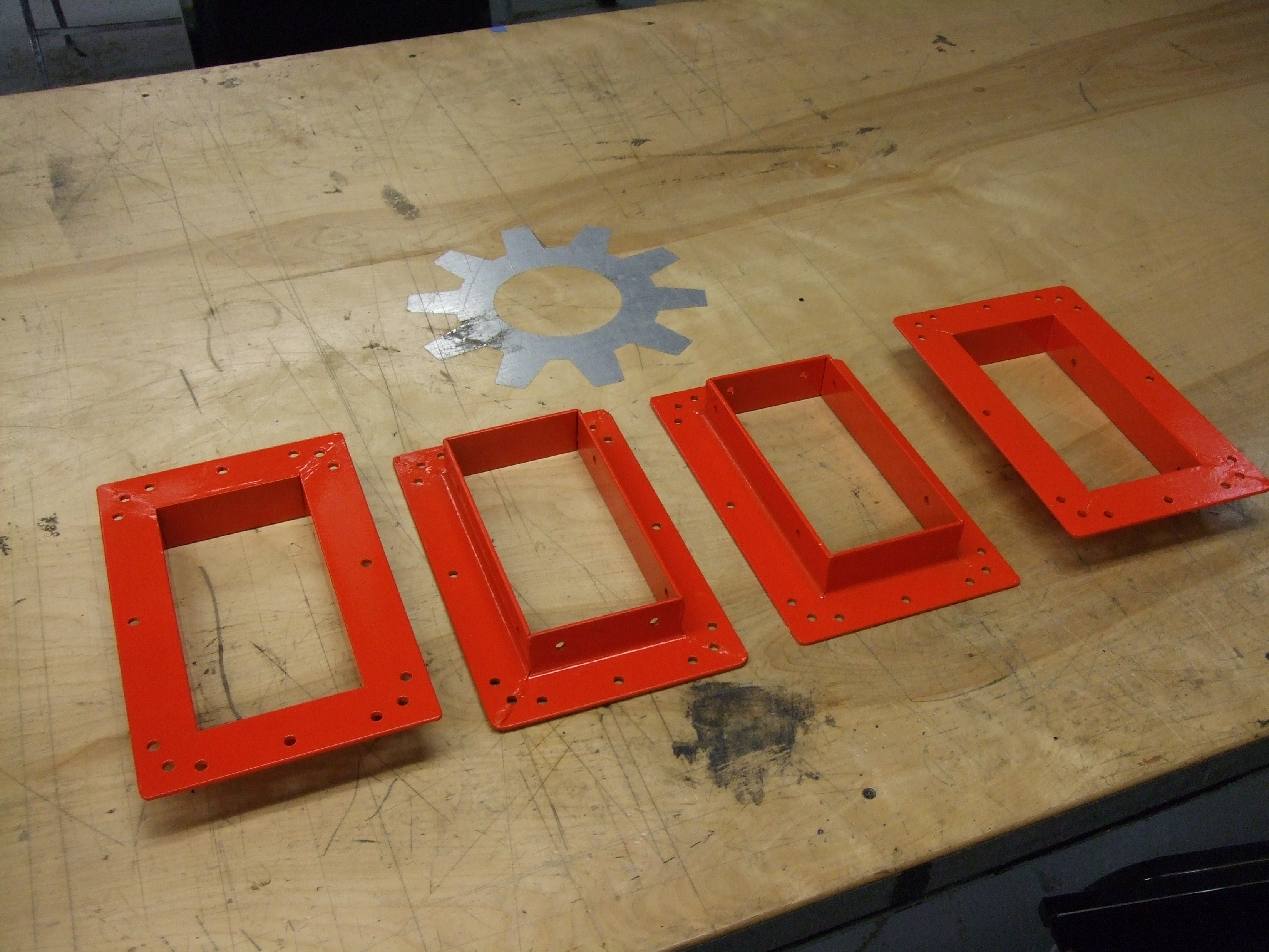

Step 1: Mounting Plates

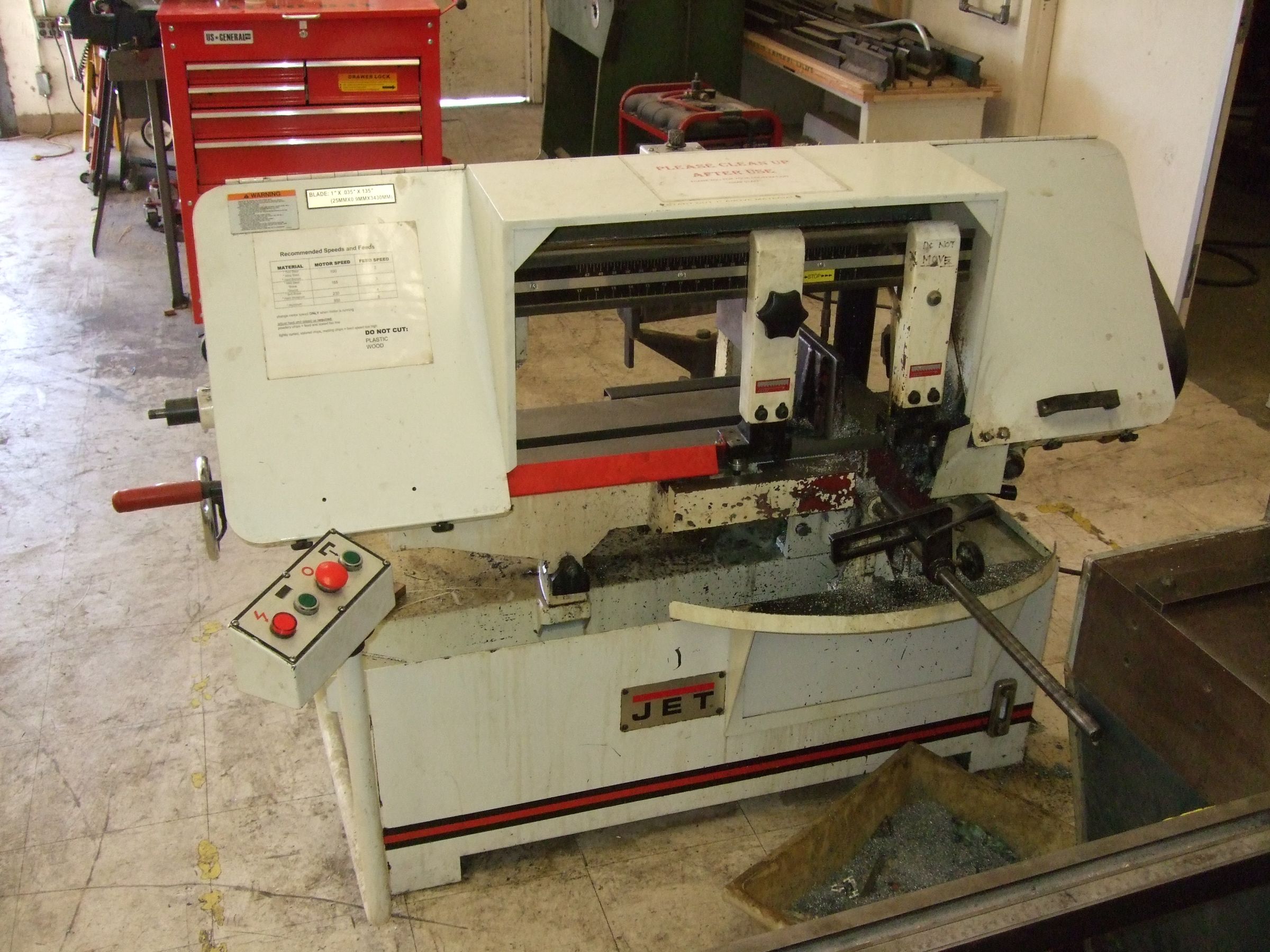

With four linear actuators from eBay, I started by sketching the layout in Autodesk Inventor, found some appropriately wide scrap in the yard at the TechShop, and fabricated bracket blanks.
Step 2: Drilling Mounting Pattern
I wanted the brackets to be useful in a variety of ways, so I designed the layout carefully to allow for mounting at a variety of angles. Wrote a bit of G-code and drilled out the patterns on the Tormach CNC mill.
