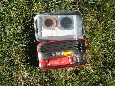

Things you need.
1) a broken sole.
2) the cheapest bicycle-tyre repair kit money can buy.

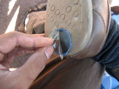

Step 2: Find the Worn-out Area
- Mark the worn out area with a cheerful-colored crayon. This is to prevent us from missing the area that needs to be repaired.
- Decide on the tab (from the repair kit that you have bought earlier) that fits the worn-out area perfectly. Make the decision.
Step 3: Applying Adhesives
- Clean the marked area and apply a thin layer of adhesive on it (the adhesive is from the repair kit too). let the adhesive become tacky.
- This may take a few seconds - a time to have a nice quick appreciation of your green surrounding.
Step 4: Fix It
- When the adhesive is tacky enough, place the tab over it.
Step 5: Done
- Let it dry for a few minutes - and done. Hope that helps! :)

    Any word on how well this holds up to wear? It's a clever trick, especially if it lasts.
    0
    faizzohri
    faizzohri
    Reply 10 years ago on Introduction
    it holds up quite good. the rubber last for 3 months or so ( i wear the shoe almost daily) the patch is mainly to stop the crack on the sole from opening up more.... but going to the shoe shop for a new sole is the long-term solution. : )
