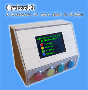

QuizzPi is an arcade type trivia game. QuizzPi was born becasuse I had the need to give my daughter an entertainment. She is 7 years old and she already demands the use of new technologies, the idea was to create something that was both fun and educational.

    First thing we need is to know how many space we need to include hardware (Raspberry + screen + buttons + battery + wires). Taking into account the parts described in the previous step I made a 3D design of the case using the free online 3D designer Tinkercad (See).If you want to print the 3D model of the case you can download it from the attached file QuizzPi case.stl.
    At that moment I had to decide whether to print the model on my 3D printer or make it out of plywood. I thought that being for my daughter I could spend a little more time making it out of plywood. So I get the plans from the 3D model and cut the wood.
    Next step is hot-glueing the parts...
    Step 3: Making the Plywood Case...
    Once I had cut all plywood parts of the plans next step is hot-glueing them. In some joins I put reinforcements to make the box stronger. In the bezel I draw with the pencil the outline of the LCD screen, and cut it out. I make four holes for the screws. If you use a different screen you must modify this thing.
    Back door closes with two magnets glued to the door and two magnets glue to the case, so I avoid the use of hinges.
    The QuizzPi case is finished...

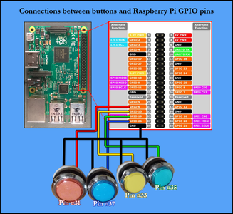

    We need to connect the buttons to the Raspberry Pi so it can know what button are pushed. Buttons are connected to GPIO pins. We need four IN GPIO pins plus one Gnd GPIO pin. I used GPIO pin 31 (GPIO6), 33 (GPIO13), 35 (GPIO19), 37 (GPIO26) and 39 (Gnd) for red, yellow, green and blue buttons respectively. This screen has SPI interface. This means that it is connected to GPIO bank, so firstly I put wires ended in square in buttons pins and then I connected the LCD screen.

    To place the buttons and wiring them was easy. The buttons have 2 pins, one pin of every button connects to a common cable that goes to a ground GPIO pin, and the other pin of the button connects to its respective GPIO pin of the raspberry. The wiring diagram is shown in the diagram attached.
