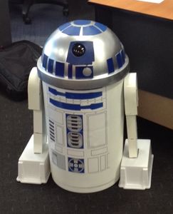

I wanted a R2D2 Bin for my office - but at over $300 it was a bit steep for a fully licensed edition, so when I found the Bullet Bin at my local Bunnings Warehouse I knew that this would be a great starting point. This is by no means a fully accurate R2, just something the conveys the idea. total cost was about $50

So into the spray booth it went (under my house). Primed and then painted with satin white and chrome for the dome - about 3 coats each.
Then I found an awesome high quality paper craft version of R2D@ and enlarged it and cropped it, then printed the front panel onto photo paper and glued it into place.
Then using the paper craft file as a reference I found some matching paint cards from the bunnings store and cut them into the wedges and rectangles I needed for the dome.
R2's eye was made with foam camping mat- great for compound curve of the dome. painted with PVA glue and the painted with gloss blue paint. the lens was made with a clear Christmas decoration, hacked to size with a dremal, with black sprayed on the back to keep the shiny stuff... um shiny.
Legs were a bit of an issue - I tried thick card over balsa wood, but that didn't look so good. so I went back and did the legs out of MDF. - Glued together and then painted - I then went over the sawn edges with styrene and a heat gun and glued them on.
Feet are definitely not regulation - they are just plastic storage bins upside down with holes cut in the top.
Improvement to finish and fix.
- shoulders - probably some big mailing tube will do the trick.
- needs two projectors - powerade bottle tops painted silver look to be a cheap option.
One day I'd like to make a more accurate R2, but for the moment Bin2 will do fine.
