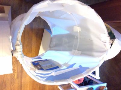

  1. Cut some plastic tubing a few inches longer than the circumference of the bottom of the dome. I used some flexible white tubing from the plumbing section of the hardware store. For the top hoop, I threaded two unbent wire hangers into the tubing, to give it some extra stiffness.
  2. Thread the tubing through two threaded PVC tees (sorry, didn't take pictures of it unassembled -- here's what they look like). To each tee, attach a short PVC nipple (that's what they call them), and then a 90-degree elbow that's threaded on the one side, and slip-fit on the other (like this). The slip-fit end of the elbow fits over the top of the leg, like a cap. I leave it to you to figure out what sizes to get, depending on what size tubing and PVC you end up with (I had a bunch of 3/4" schedule 40 PVC from another project, so that's what I used for the legs).
  3. Overlap the tubing ends, and tape them together with duct tape, making a hoop of the same circumference as the dome (or maybe a tiny little bit smaller, if it turns out that you are not that great at paper mache and your dome is actually a bit, um, not perfectly circular).
  4. Tape the top of the shower curtain body to the top hoop. This involves folding over the top of the curtain and lots of (white) duct tape. (You can see the tape through the shower curtain, so I went with white.) It occurs to me just now that it might have been easier to tape the tubing to the curtain first, then make the tubing into a hoop. Ah well, next time.
  5. Cut slits on the sides of the shower curtain body, for the kid to be able to hold the legs (note the kid's hand in the first photo, demonstrating the ergonomics of the costume).
  6. Make and attach two more hoops, one in the middle and one at the bottom. I added the middle hoop to keep the body from sagging (the first photo here is of the body with only the top and bottom hoops, as is the photo in the previous step with C3PO).

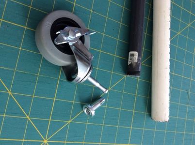

  1. Attach casters (lightweight casters will do -- I had these from a previous project) to the bottom of the PVC pipes. I forgot to take an unassembled photo, but I capped the bottom of the PVC leg with a threaded reducer bushing (like this one). First, I drilled a little hole in the bushing so the tapered end of the caster holder metal thingy (see the first photo) would fit through it, then threaded in a nipple and cut it off flush with the bushing (the gray tube you see in the first photo is what remains of the nipple), and then smashed the metal thingy into the bushing. I squeezed a little two-part epoxy into the works, for good measure. Then I put the wheel into the metal thingy, and attached the whole assemblage to the PVC leg with a coupler (that's all you can see in the second photo -- the attached wheel and the coupler). Main thing is, attach whatever wheels you get securely to the legs. My fallback, if the trip to the plumbing aisle hadn't panned out, was to use a block of wood, some screws, and some cleverness.
